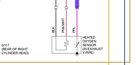

CDOWD
  • 25 POSTS
Hey thanks so much its the oxgen sensor I did a test and it gave me a code the code was 13 which in the maual code 13 says oxagen sensor but I have on last? Ok I can not find were to hook the oxagen sensor up at because some one took it out so ther for I cant find the wire to plug the o2 sensor in at
Saturday, April 11th, 2009 AT 8:18 AM
  • 75,992 POSTS
Heres the wires that goes to the O2 sensor-see below
https://www.2carpros.com/forum/automotive_pictures/12900_O2_wire_colors_1.jpg
Saturday, April 11th, 2009 AT 9:25 AM
CDOWD
  • 25 POSTS
Ok but my? Is what if I dont have them wires. Becase someone took them off and I dont have cats the y pipe has been cut off.
Saturday, April 11th, 2009 AT 10:28 AM
  • 75,992 POSTS
You need to do something about it-I've given all I got-you need to get a repair/service manual and track the wires.
