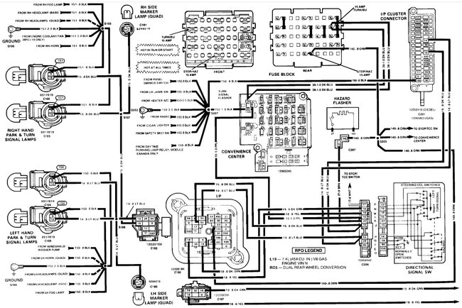

My plow truck (which passed inspection) has a taillights problem. The hazards and directionals work in the rear but the taillights, parking lamps, brake lights and back up lamps don't light. Fuses and circuit breakers appear fine. I've done no work on the lights and I'm sure they worked before.
Any suggestions of where to look next?
3500 Dually extended cab.
Also, I've cleaned up the trailer connector, so I don't think it was shorting out.

Test the headlamp switch and continuity of the wires.
Friday, December 7th, 2007 AT 3:08 PM
KEN L
  • MASTER CERTIFIED MECHANIC
  • 47,513 POSTS

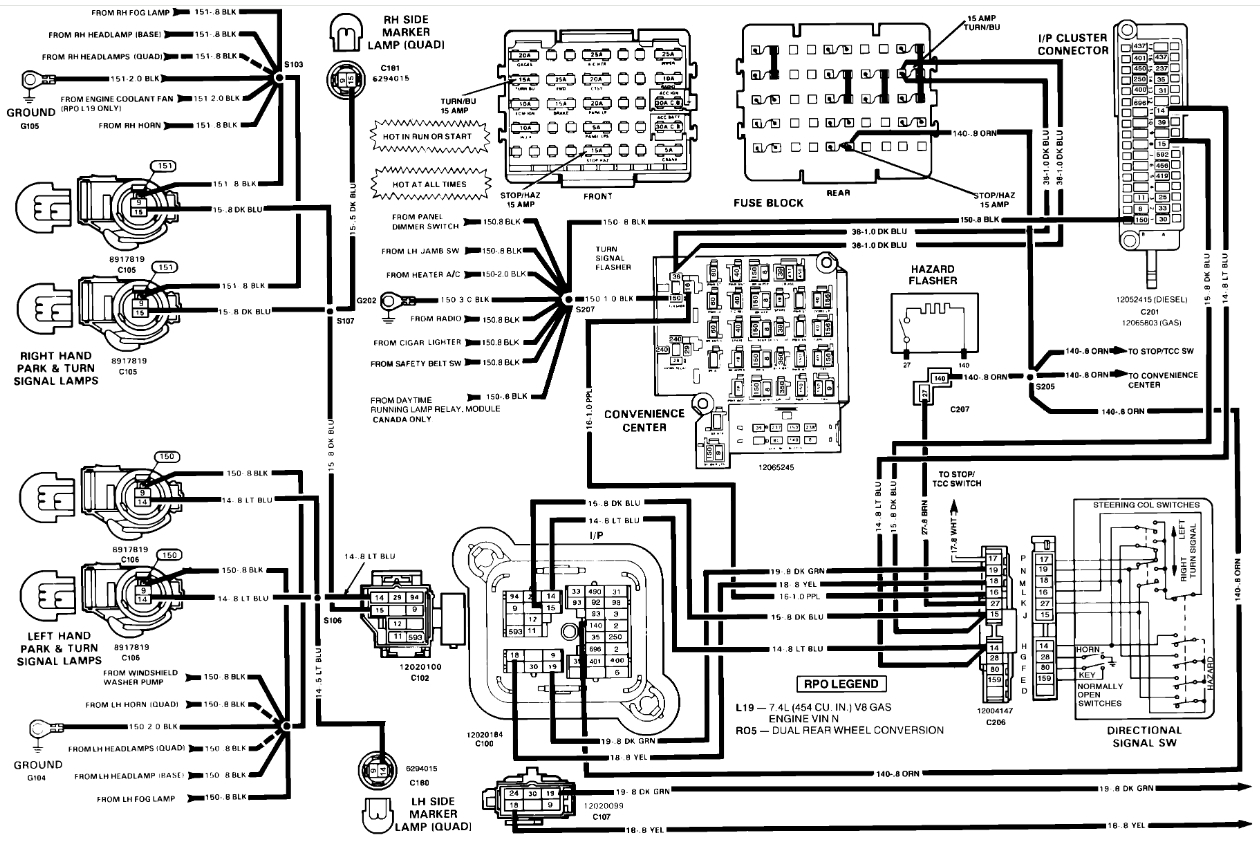

I would check for power when the lights are on at the lighting socket. Here are two guides that can help you because it sounds like you have a bad ground connection. I have included the lighting wiring diagrams so you can see how the system works.
and
https://www.2carpros.com/articles/no-tail-lights-exterior-running-lights-tail-lights-out
Check out the images (below). Let us know what you find.
