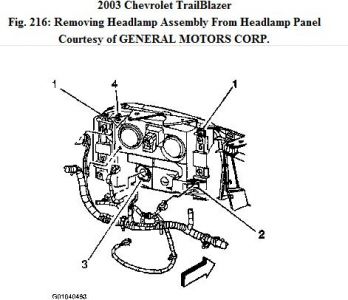

JAMALCOM
  • 2003 CHEVROLET TRAILBLAZER
2003 Chevy Trailblazer
how to replace low beam headlight on passenger side
nothing in manual
Thursday, January 7th, 2021 AT 10:28 AM (Merged)
MASTERTECHTIM
  • 4,750 POSTS
Pull up the #1 rods and this will release the light assembly and it will pull straight out
https://www.2carpros.com/forum/automotive_pictures/139033_no_19.jpg
+1
