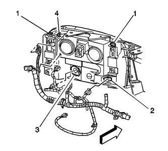

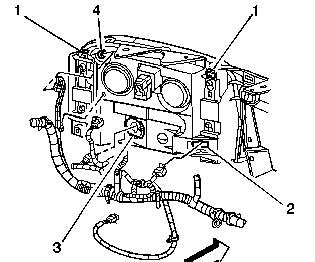

DENNYP
  • 1,824 POSTS
XTooltipElement Service Information
2005 Chevrolet TrailBlazer - 4WD | Envoy, Rainier, TrailBlazer, Ascender (VIN S/T) Service Manual | Body | Lighting Systems | Repair Instructions | Document ID: 742449
Headlamp Replacement (TrailBlazer)
Removal Procedure
Open and support the hood.
Remove the grille. Refer to Grille Replacement .
Pull up on the retaining tabs (1) in order to remove the headlamp assembly from the headlamp panel.
Disconnect the headlamp leveling electrical connector from the motor/actuator if equipped.
Disconnect the headlamp electrical connector (2) from the headlamp assembly.
Remove the side marker socket (4) from the headlamp assembly.
Remove the park/turn socket (3) from the headlamp assembly.
Remove the headlamp assembly from the headlamp panel.
Installation Procedure
Position the headlamp assembly to the headlamp panel.
Index and seat the tabs on the park/turn socket (3) to the headlamp assembly.
Index and seat the tabs on the side marker socket (4) to the headlamp assembly.
Connect the headlamp electrical connector (2).
Connect the headlamp leveling electrical connector to the motor/actuator if equipped.
Align and install the 4 locator pins on the back of the headlamp assembly into the retaining tab holes.
Push down on the retaining tabs (1) in order to lock the headlamp assembly into the headlamp panel.
Install the grille. Refer to Grille Replacement .
Close the hood.

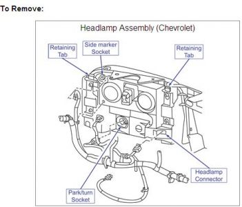

WALT09
Hi-
I just did mine this afternoon after looking for an answer myself on this web site. I saw a diagram responding to one of the 2003 TB headlight replacement questions (there are several with the same question.)
The process wasn't too bad and didn't take that long.
The front grill comes off with a little encouragement: there are 4 clips along the top, 2 on each side in the middle of each headlight assembly, 2 on the bottom - 1 on each side near the headlight assemblies, and 1 in the middle behind the Chevy logo. Once the grill is off you have access to each headlight assembly.
I found a tab at the top on each side of the assembly that pulls up. It took some doing to pry the ones on the outside because they were hard to get to. Pulling both tabs up releases the assembly. I disconnected the headlight connector and also removed the turn signal light with its connector attached. I left the side light and connector attached with the assembly. I swung the assembly to the outside and removed the dust covers for each light (low bean 9006 on the outside and hi beam 9005 on the inside). I replaced both lights because I didn't want to go through this process again any time soon. I put the dust covers back on and did everything in reverse. I checked each headlight assembly after I replaced those lights and only put the decorative grill back on when I knew all the lights were working properly. The most difficult task was replacing the lights on the right/passenger side of the car. The ones on the left/driver side were much easier to both remove and install.
Good luck with your replacements.

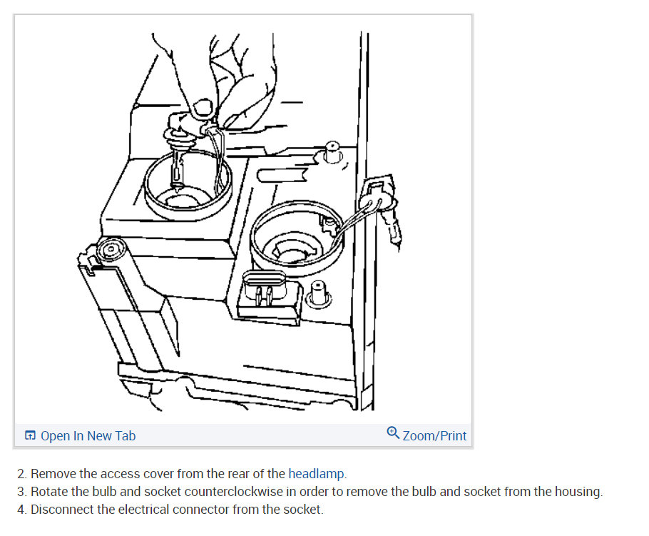

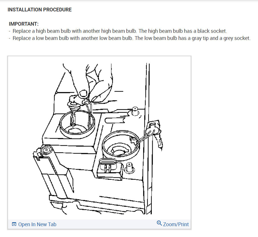

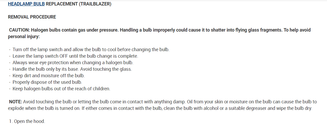

  • 109,896 POSTS
Removal Procedure
Caution: Halogen bulbs contain gas under pressure. Handling a bulb improperly could cause it to shatter into flying glass fragments. To help avoid personal injury:
- Turn off the lamp switch and allow the bulb to cool before changing the bulb.
- Leave the lamp switch OFF until the bulb change is complete.
- Always wear eye protection when changing a halogen bulb.
- Handle the bulb only by its base. Avoid touching the glass.
- Keep dirt and moisture off the bulb.
- Properly dispose of the used bulb.
- Keep halogen bulbs out of the reach of children.
Notice: Avoid touching the bulb or letting the bulb come in contact with anything damp. Oil from your skin or moisture on the bulb can cause the bulb to explode when the bulb is turned on. If either comes in contact with the bulb, clean the bulb with alcohol or a suitable degreaser and wipe the bulb dry.
1. Open the hood.
2. Remove the access cover from the rear of the headlamp.
3. Rotate the bulb and socket counterclockwise in order to remove the bulb and socket from the housing.
4. Disconnect the electrical connector from the socket.
Important:
- Replace a high beam bulb with another high beam bulb. The high beam bulb has a black socket.
- Replace a low beam bulb with another low beam bulb. The low beam bulb has a gray tip and a grey socket.
1. Connect the electrical connector to the socket.
2. Position the bulb and socket to the headlamp.
3. Install the bulb and socket to the housing by rotating the bulb and socket clockwise, locking the retaining tabs to the housing.
4. Install the access cover to the rear of the headlamp assembly.
See picture below

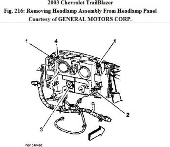

M.LARSON
  • 2003 CHEVROLET TRAILBLAZER
  • 6 CYL
  • 2WD
  • 114,000 MILES
How do I replace the headlight bulb in the 2003 Chevy Trailbalzer?
Thursday, January 7th, 2021 AT 10:27 AM (Merged)

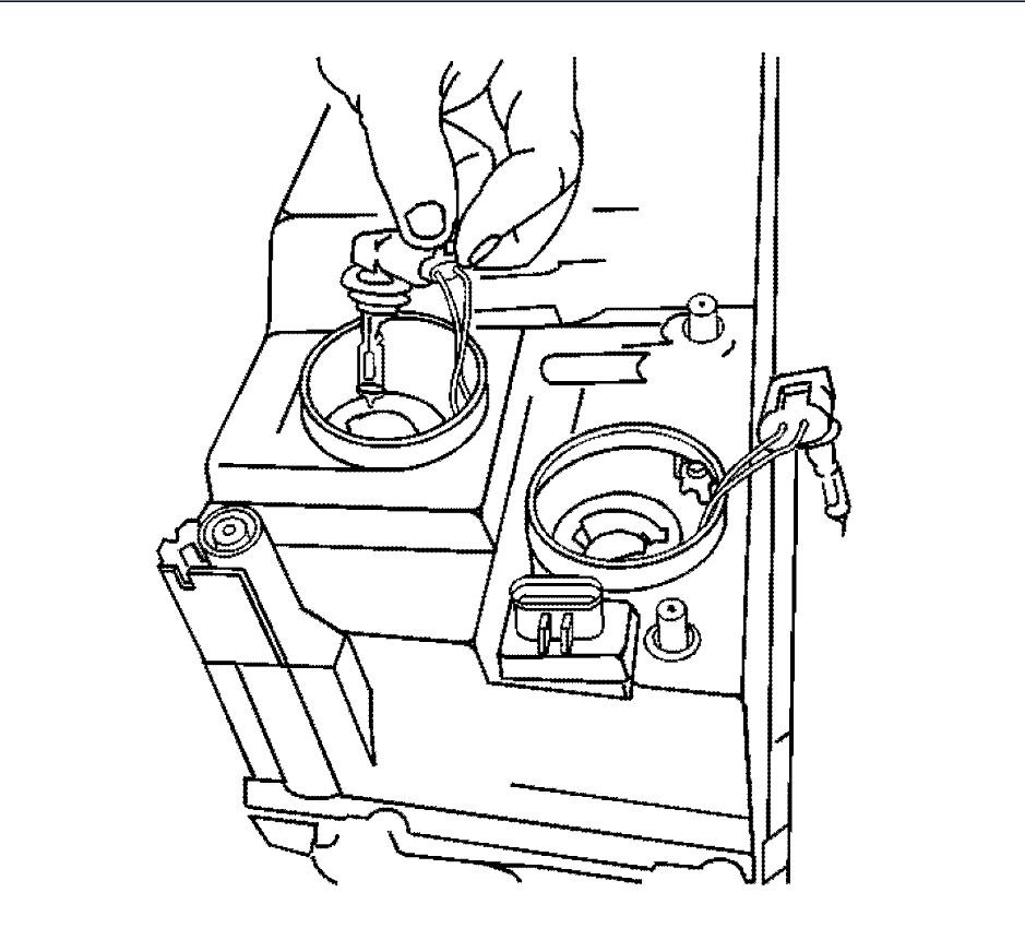

JDL
  • 16,098 POSTS
https://www.2carpros.com/forum/automotive_pictures/170934_chevy_trailblazer_1.jpg
https://www.2carpros.com/forum/automotive_pictures/170934_trailblazer1_1.jpg
https://www.2carpros.com/forum/automotive_pictures/170934_trailbazer_2_1.jpg

  • 75,992 POSTS
HEADLAMP REPLACEMENT
REMOVAL PROCEDURE
1.Open and support the hood.
2.Remove the grille.
https://www.2carpros.com/forum/automotive_pictures/12900_hl_1.gif
3.Pull up on the retaining tabs (1) in order to remove the headlamp assembly from the headlamp panel.
4.Disconnect the headlamp leveling electrical connector from the motor/actuator if equipped.
5.Disconnect the headlamp electrical connector (2) from the headlamp assembly.
6.Remove the side marker socket (4) from the headlamp assembly.
7.Remove the park/turn socket (3) from the headlamp assembly.
8.Remove the headlamp assembly from the headlamp panel.
INSTALLATION PROCEDURE
1.Position the headlamp assembly to the headlamp panel.
2.Index and seat the tabs on the park/turn socket (3) to the headlamp assembly.
3.Index and seat the tabs on the side marker socket (4) to the headlamp assembly.
4.Connect the headlamp electrical connector (2).
5.Connect the headlamp leveling electrical connector to the motor/actuator if equipped.
6.Align and install the 4 locator pins on the back of the headlamp assembly into the retaining tab holes.
7.Push down on the retaining tabs (1) in order to lock the headlamp assembly into the headlamp panel.
8.Install the grille.
9.Close the hood.
