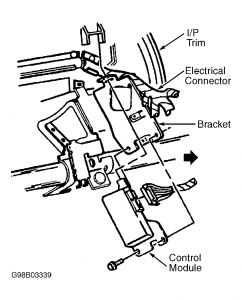

OK lets do a test to see what we need to do here. First I will need you to get to and unplug the 4x4 control module I have include a pic of where it is. Now I will need you to make a jumper wire so you connect each circuit to gound. So the pink and white wire ground it does this make the 4x4 low light light up? Now take the light green and black wire do the same and the pink wire and the tan and black. Did all the lights come one one at a time? If yes then the module is no good and need to be replaced. Let me know what you find.

Which side of the steering column is the 4x4 control module on? What I have located is on the left. It is 4inx5in x 2in thick. It has two plugs, one with 4 wires and one has about 30. I don't see a white ground. Help
-3
Wednesday, March 4th, 2009 AT 3:39 PM
RACEFAN966
  • 5,029 POSTS
It is on the left side of the column and the wire colors are like pink with white trace meaning the wire is pink and has a white stripe and the other wires are ment in the same manner. The module is on the steering column support bracket. Let know what you find.

First off no need to get frustrated I am trying to help and trying to do that with out the vehicle infront of me, much harder to do that way. Otherwise here is a pic of the t-case module I hope this will help..
