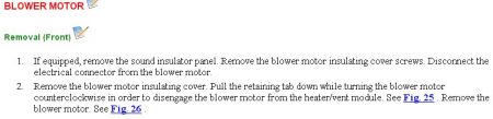

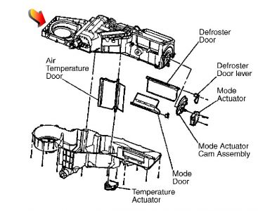

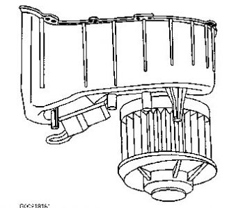

I have a noise that sounds like something is stuck in the blower when I run the A/C. How do I get a diagram of the system to access the blower and clear the foreign object.
Appreciate any help.
Wednesday, April 16th, 2008 AT 8:21 PM
SERVICE WRITER
  • 9,123 POSTS
Probably a bad squirril cage or blower motor bearing.
