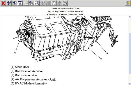

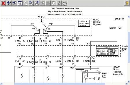

Need to repair the blower motor switch or find out why the switch now only works on high setting #5 and nothing happends on 1, 2, 3, 4,
thanks

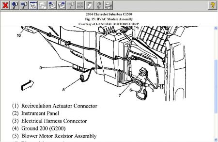

Inspect and test the HVAC control module and blower motor resistor. see below

Is this part easy to change
thanks So much

Nothing is easy when dealing with the dash-HVAC control module assy is below the instrument panel -see below for both
