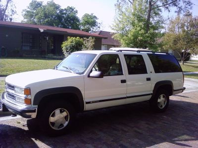

Why does my gas gauge jump from empty to full and sometimes point strait down to the temperature gauge. all the time it's bouncing around it driving me NUT'S.
https://images.2carpros.com/forum/automotive_pictures/317199_031109102800_1.jpg
