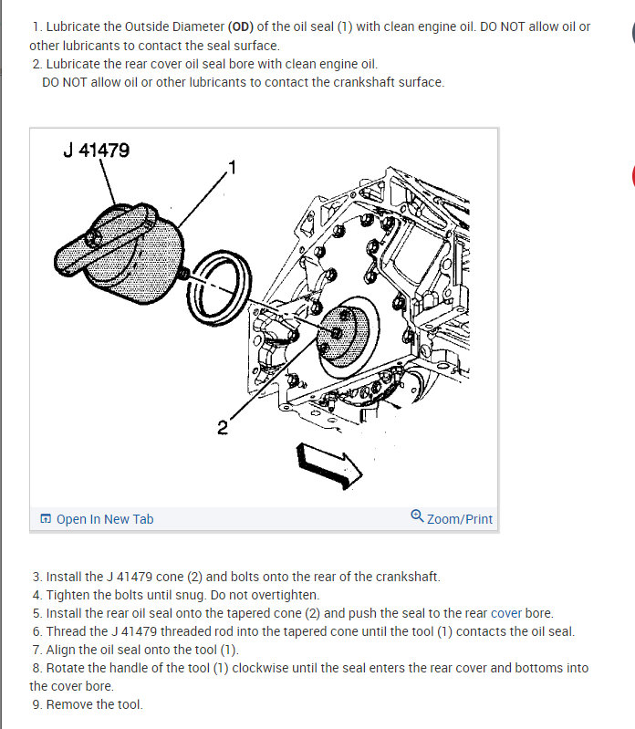

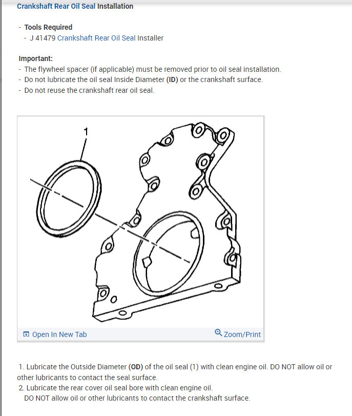

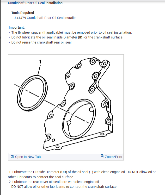

I have a leaking main oil seal - can you provide me with instructions - thanks very much for any help!
Feb 18, 2008 at 7:36 AM
This is a pretty common failure so here are a number of guides that will help with this. Please run through this and let us know if you have questions on this.
https://www.2carpros.com/articles/symptoms-of-a-front-crankshaft-seal-leak
https://www.2carpros.com/articles/front-main-seal-replacement
https://www.2carpros.com/articles/crankshaft-main-seal-replacement-rear
Below you will find the detail from the manual as well. Please let us know how this works out. Thanks
