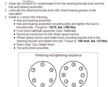

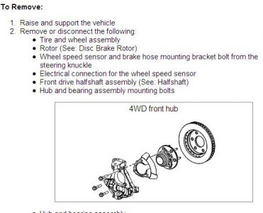

https://images.2carpros.com/forum/automotive_pictures/170934_2000_chevy_1_1.jpg
https://images.2carpros.com/forum/automotive_pictures/170934_2000_chevy_11_1.jpg
My info is for the 2500, the database info is fairly basic. I don't see why you can't do it yourself. If the assembly is a press fit to the driveshaft, you may need a puller or equivalent to get it loose. If the front end alignment is affected, you may have to get it realigned. I can't think of anything else, right off hand that may give you a problem? Maybe some of the others will have something? Oops, racefan966 beat me to it, I'm a slow typer.
