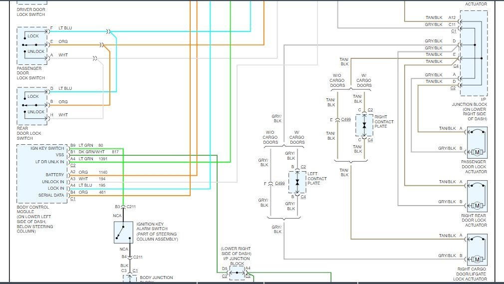

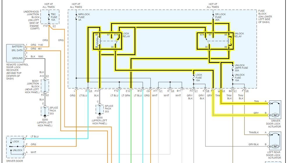

my power locks ,other than the drivers door, wont lock with any of the switches
Feb 13, 2010 at 9:26 PM
  • CAR REPAIR CONTRIBUTOR
Good morning,
I attached the wiring diagram for you to view. There are a series of fuses for the locks. Check them with a test light or voltmeter on both sides for power.
If the fuses are good, there is a good chance the issue is a wiring issue.
Let us know if you have any other questions.
