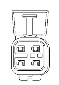

not sure which motor you have 5.0 and 5.7 should be 60-66 psi 4.8,5.3,6.0 and 7.4 are 55-62 psi If your pump had the Metri-pack 150 connector (shown below) it should have been replaced at the time the pump was done.
https://images.2carpros.com/forum/automotive_pictures/30961_mtri150_1.jpg

I went and bought a new MAF and changed it in the parking lot and it made the suburban run worse so I went and got my old one back. I made a 6 hr trip after that and it still was sluggish when I first started to go and it jerked after climbing a hill. The service engine light was still on the whole time. Then yesterday I started the car and the service engine light was off but it still runs sluggish at the beginning then it runs fine. I'm running out of ideas. I have changed the gasket you where talking about and my problems with it running rough didn't start until I changed the fuel regulator( which fixed the starting problem). I don't know what if I have that connector you are talking about. I have a 5.7l engine. It doesn't look like anything I've seen so far.
