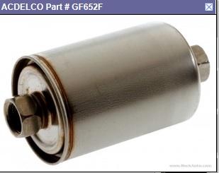

Can anyone tell me wher to find picture instructions on how to change my fuel filter on a 1997 suburban. Either that or detail instructions. Thank you.

The fuel filter should be mounted to inside frame rail, you'll need to get under the vehicle. Usually after the vehicle sits overnight without the key being cycled, there isn't much fuel pressure, but, you still need to be aware. You can disable fuel pump by pulling fuse then try to start the vehicle, to take pressure off system. Slowly take line nuts loose from filter, use a catch pan. Don't let gas hit a droplight. Don't do this in a closed garage or around any pilot lites.
To work on your own vehicles, you need a basic set of wrenches and sockets. I don't remember the actual size wrenches? The picture I posted should show you what the filter looks like.

Car is 1997 Suburban 5.7L
I know how to change a fuel filter, and have done so.
I have also changed other things with steel lines and compression fittings such as camshaft driven fuel pumps, brakes, etc.
What I never want to do again is round off the nut holding the line onto--in this case the filter.
I am using a 5/8" line wrench, and it seems like it just does not want to turn. I have sprayed oil on it over some days, now. Different kinds. Today I bought a new can that advertises it is special penetrating oil.
I got to wondering if maybe it was metric. I did the conversion on the computer and 5/8 is between 15mm and 16mm. The 15mm wrench is too big.
Any advice?

It should be standard and it really depends on what brand of tools you use, I have nothing aginst craftsman but their wrenches spread over time causing this problem, I found this out years ago and bought all snap on and mac tools since and never had that problem again try a good wrench if your not already

I would go to a vise grip that is larger enough to adequately grab on, get a good bite on the flats, and turn it IN a touch and turn it OUT a touch, and back and forth until you get more and more movement.
There are line wrenches that are valuable

I said the 15mm was too big. I meant that it was too small.
The 5/8 is a little wiggly (not much, though). My conversion shows 5/8 would be 15.875 mm. So, getting smaller would be 15mm, but that is too small.
I will probably try the vise grip pliers since someone mentioned it.
I had thought of that, but thought people usuially saved that for when the nut was already rounded.
