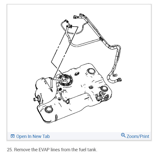

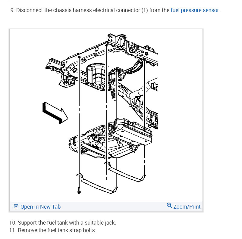

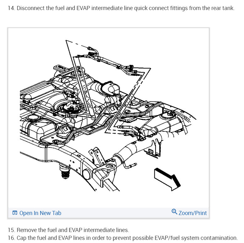

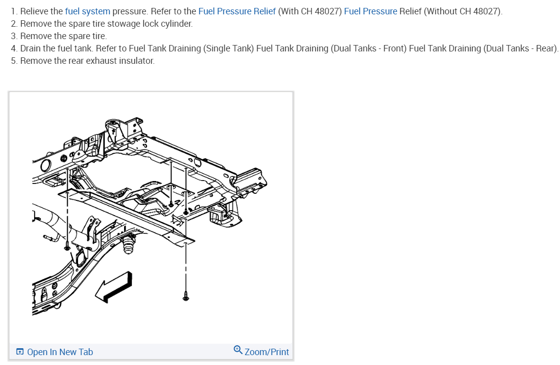

where is the fuel filter ..i am changing the fuel pump...truck acts like it is out of gas ./should i also change the fuel line for the fuel pump? can recommend a quiet fuel pump. thank you tim
Jul 26, 2010 at 2:56 PM
  • 75,992 POSTS
Here is a guide to help walk you through the steps of changing the fuel pump and fuel filter which is on the pump with instructions in the diagram below to help you change it out on your car.
https://www.2carpros.com/articles/how-to-change-a-fuel-filter
Jul 26, 2010 at 8:36 PM

The fuel filter is located on the driver side under the passenger door on the inside of the frame. Here is a guide

should be under drivers side along frame rail and a couple wrenches should do the trick.1 to hold filter nut and the other to break line loose/unscrew.

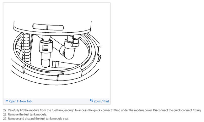

Are you able to describe the entire process of replacing the manual fuel filter on an 86 chevy suburban.
Sep 7, 2020 at 6:33 AM (Merged)
i assume you mean the gas filter
you need a 13/16 open end wrench and a 5/8 line wrench to remove the lines from the filter.
be carefull of the fuel that will come out. use protection on your hands and saftey glasses.
TONISLUG
I meant fuel pump.
the fuel tank has to be removed to gain acess to the top of the tank so you can remove the pump module.
it is a very involved job as the tank needs to be supported properly so you do not drop it. it is harder if it is full.
you may want to get a shop to do it for you as it is dangerous.

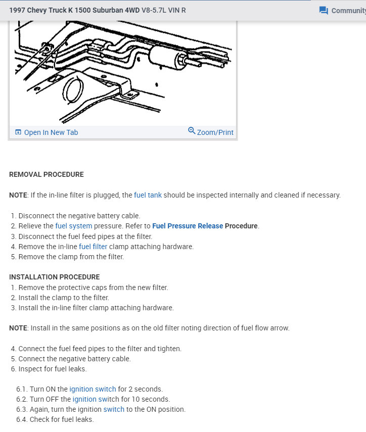

RENEE762
Can anyone tell me wher to find picture instructions on how to change my fuel filter on a 1997 suburban. Either that or detail instructions. Thank you.
JDL
  • 16,098 POSTS
Sorry for the late reply.
The fuel filter should be mounted to inside frame rail, you'll need to get under the vehicle. Usually after the vehicle sits overnight without the key being cycled, there isn't much fuel pressure,but, you still need to be aware. You can disable fuel pump by pulling fuse then try to start the vehicle, to take pressure off system. Slowly take line nuts loose from filter, use a catch pan. Don't let gas hit a droplight. Don't do this in a closed garage or around any pilot lites.
To work on your own vehicles, you need a basic set of wrenches and sockets. I don't remember the actual size wrenches? The picture I posted should show you what the filter looks like.
I realize this an old post. In the future hope you don't have any vehicle issues, but, if do, keep the site in mind. They are always working to improve the site and it's free to ask a question.
Have a good day.
