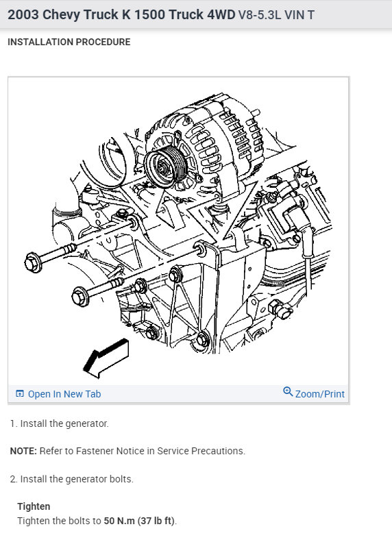

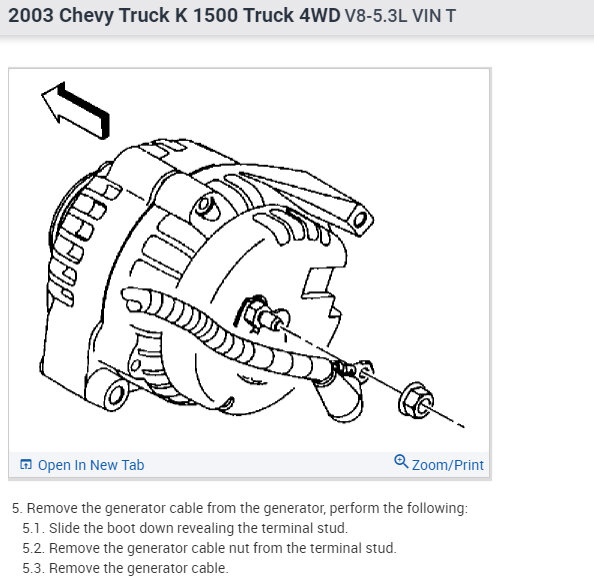

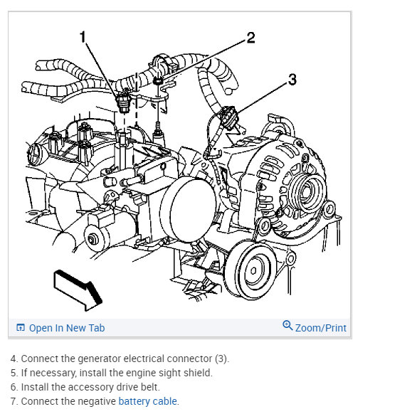

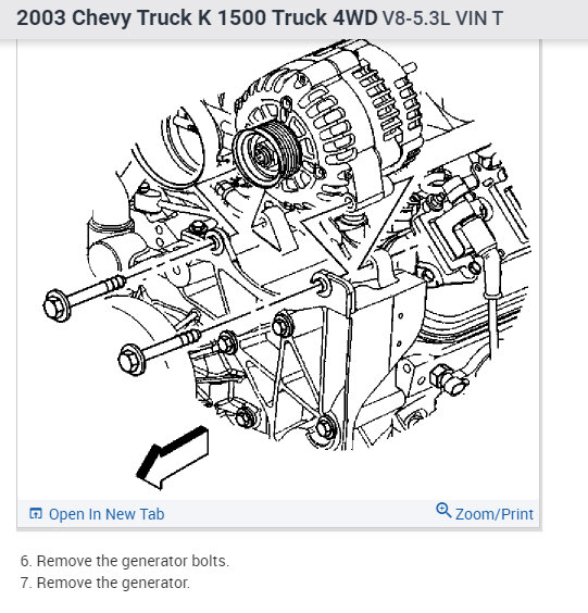

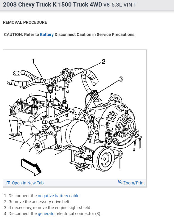

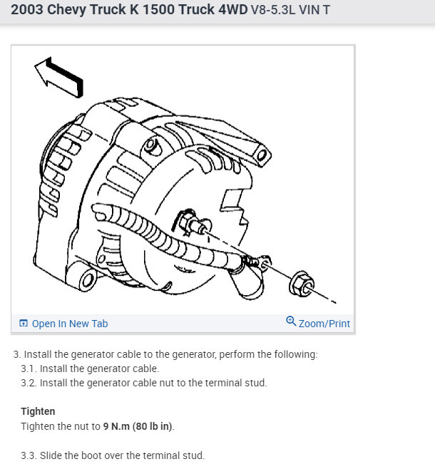

See attached for the alternator replacement procedure on the 2003 Silverado with 5.3L engine.

Suggested Repair
Release belt tension by rotating the belt tensioner, then remove the belt from the alternator so the alternator can be taken out. Do not try to force the belt off with a screwdriver.
