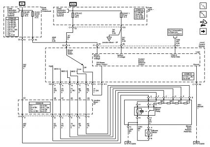

2005 Chevy Silverado, 92000 miles, the a/c blower stopped blowing however the compressor still works because if I am going down the road cool air comes out of the vents. I have checked all of the fuses I know to check. What am I missing. It was working one minute. I went into a store and when I came out and started the truck, it did not work.

[quote:c76528c36d="howdy_ag"]2005 Chevy Silverado, 92000 miles, the a/c blower stopped blowing however the compressor still works because if I am going down the road cool air comes out of the vents. I have checked all of the fuses I know to check. What am I missing. It was working one minute. I went into a store and when I came out and started the truck, it did not work.[/quote:c76528c36d]the most common problem I see is a melted blower resistor and connector.

normally if it is the resistor you should dtill have high speed[/quote:e78a7951a0]On the 05' high speed goes through the resistor also.

the most common problem I see is a melted blower resistor and connector.[/quote:d68770ab58] normally if it is the resistor you should dtill have high speed[/quote:d68770ab58]On the 05' high speed goes through the resistor also.[/quote:d68770ab58]
https://images.2carpros.com/forum/automotive_pictures/102900_blower_1.jpg

Subject: EI05082 - Loss of Blower Motor Speeds Except for Low Speed or Inoperative (Replace Blower Motor Resistor and Resistor Module Connector) keyword fan #05-01-38-012C - (11/02/2006)
Models: 2004-2006 Chevrolet Avalanche, Silverado, Suburban, Tahoe, TrailBlazer, TrailBlazer EXT
2007 Chevrolet Silverado (Classic) Built Prior to September 1, 2006
2004-2006 GMC Envoy, Envoy XL, Sierra, Yukon, Yukon Denali, Yukon XL
2007 GMC Sierra (Classic) Built Prior to September 1, 2006
with HVAC System AC Front, Manual Temp Control (RPO CJ3) or Heater Only (RPO C42)
This bulletin is being revised to clarify the Warranty Information. Please discard Corporate Bulletin Number 05-01-38-012B (Section 01 -- HVAC).
Condition
Some customers may comment that the blower will only work on low speeds or has become inoperative.
Correction
REPLACE THE BLOWER MOTOR RESISTOR AND RESISTOR MODULE CONNECTOR.
Replace the blower motor resistor and module connector using the following procedure:
Remove the blower fuse.
• Fullsize Trucks and Utility Vehicles -- Htr A/C & HVAC 1 fuses
• Midsize Utility Vehicles -- Blower Fuse 35 located in the Underhood Fuse Block
Lower the hush panel or close-out panel enough to gain access to the resistor module connector.
Disconnect the connector from the resistor module.
Remove the tape from the wiring harness to expose the wiring.
Cut the wires back far enough from the connector to eliminate any melted insulation on the wire.
Tip
Use the old connector as a map for splicing the wires for the new connector. Be sure to use the correct crimping tool from the terminal repair kit J 38125. Use only Duraseal splice sleeves. Other splice sleeves may not protect the splice from moisture or provide a good electrical connection.
Install the new connector. Use the yellow splice sleeves provided with the connector.
Install new blower motor resistor.
Reinstall the fuse or connector block. Test the blower motor to make sure all speeds are functional.

Thank you so very much. With yours and my husband's knowledge, we were able to fix my problem for under $30.00. The dealership would have had us come up there and hook it into the computer, which would have been an extreme waste of $100.00. And then the money to fix it, which I don't have. Using the information you gave, I was able to disconnect the blower motor resistor myself in preparation for my husband to hook up the new one. I feel so fortunate that the information was available to a person like me who knows next to NOTHING about electronics or autos!
Just like several other folks had mentioned, the 1st and last speed on the AC quit working, and then months later, no air blew out at all. I know now if any of the speeds quit working, it's time to start diagnosing the problem. My resistor was completely melted, just as you said was most common, and had started to melt the wiring and resistor connector. I didn't even know what one was two days ago. By reading these posts, it seems to me Chevy has a problem in this area, and they should be paying to fix it on all our vehicles!
