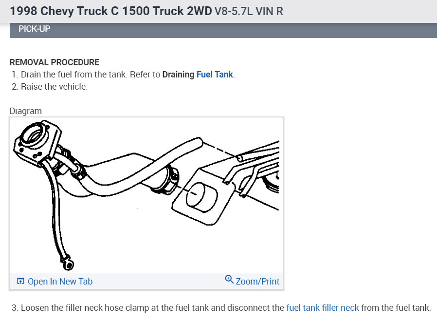

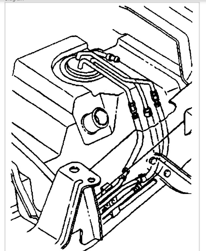

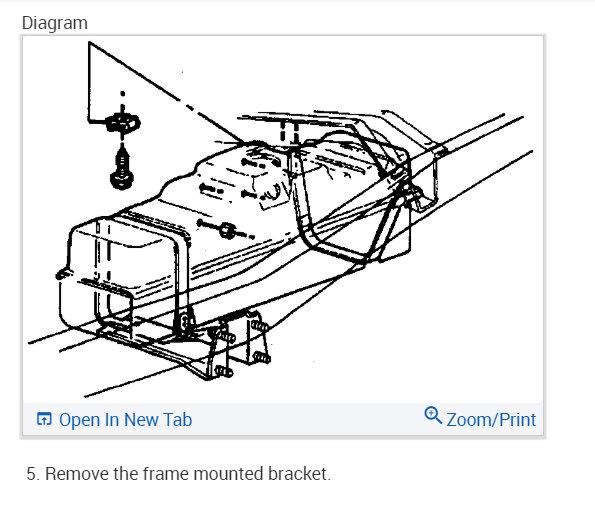

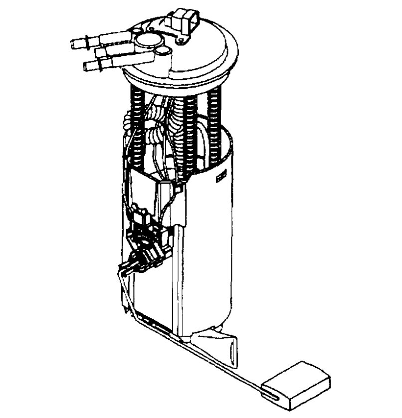

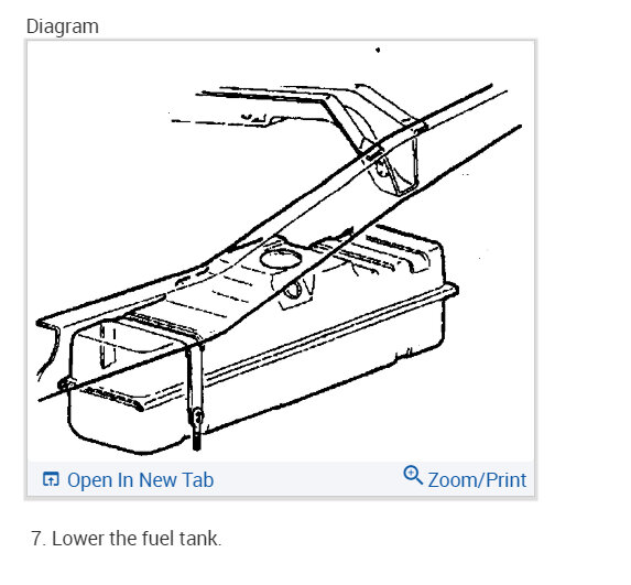

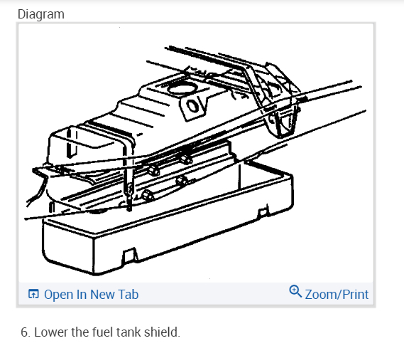

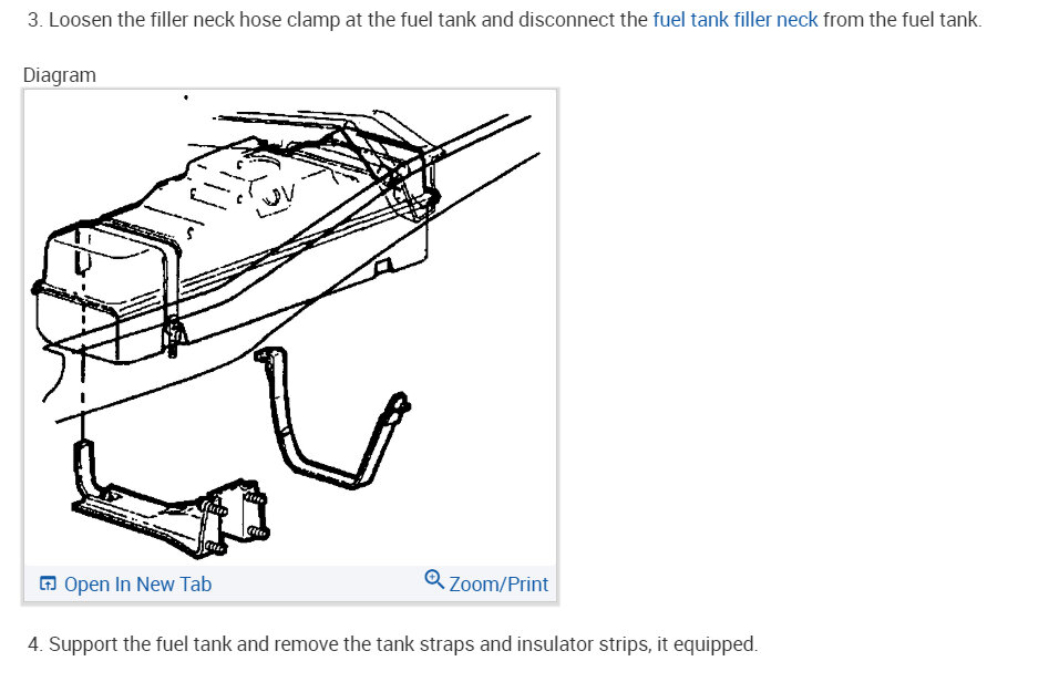

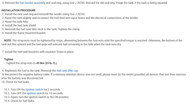

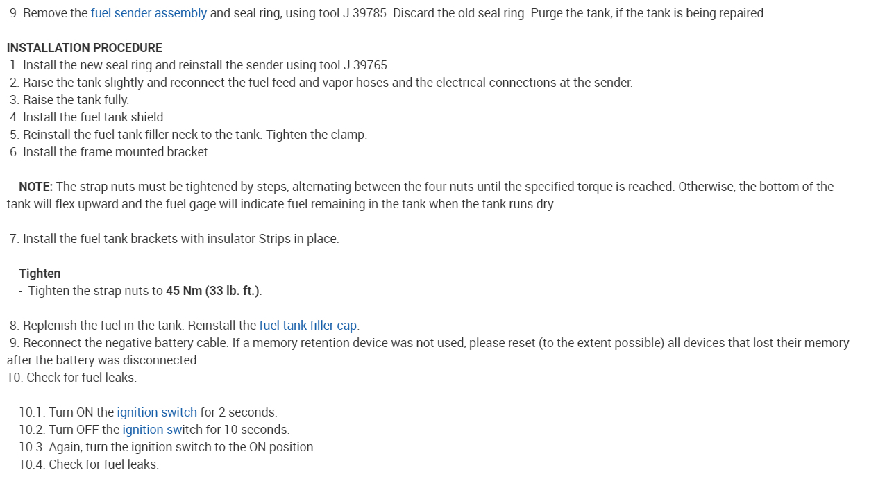

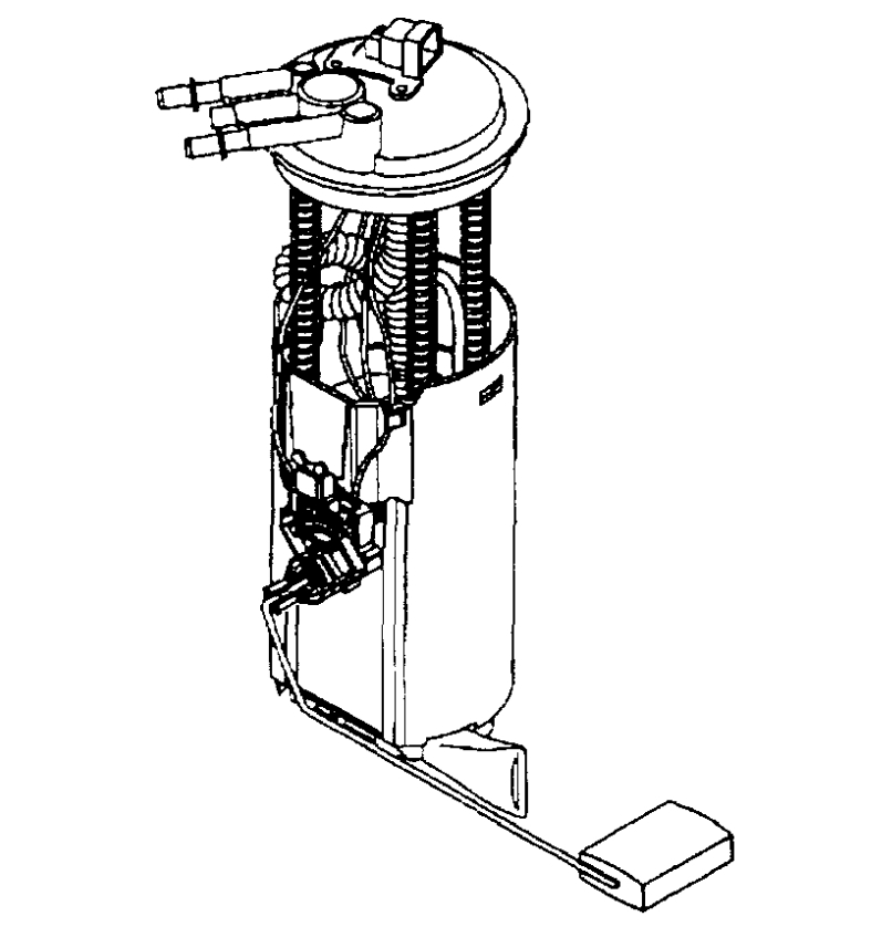

There is one thing that comes to mind when I read this and that would be timing? backfire and run-on are symptoms of timing being too far advanced, if that is okay these trucks had problems with the fuel pump. Here is a guide to help you test it which it should above 48 PSI.
Here is how to change the fuel pump pout if you find the pressure being low. Check out the images (below). Let us know how it goes
