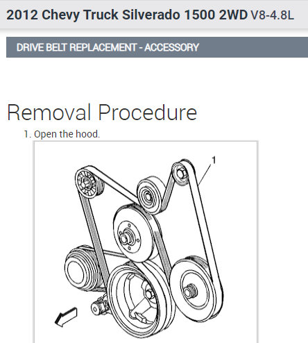

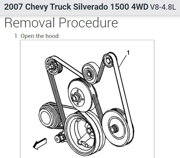

Glad to hear you like our site! Here is a tutorial showing how to replace a serpentine belt:

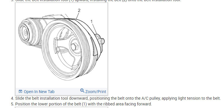

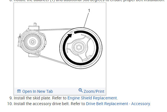

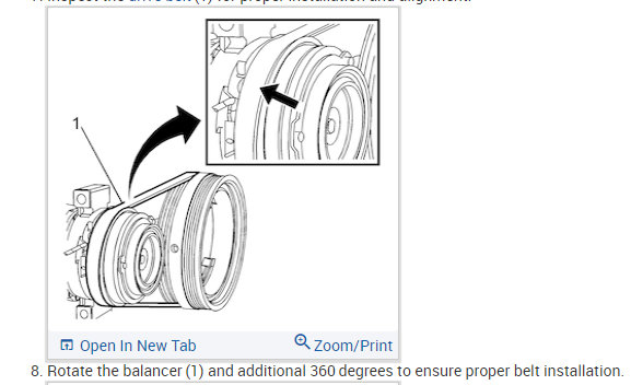

I've attached picture steps below on how to remove and replace both the engine and A/C serpentine belt for your truck. Hope this helps and thanks for using 2CarPros.

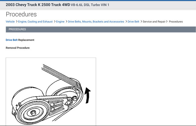

how to install serpentine belt on an 07 chevy silverado 3500 with a 6.6L diesel
Feb 24, 2021 at 4:53 AM (Merged)
KHLOW2008
  • 41,814 POSTS

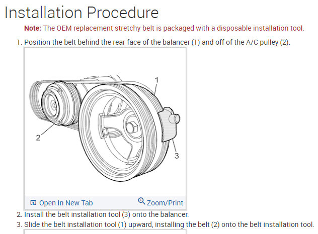

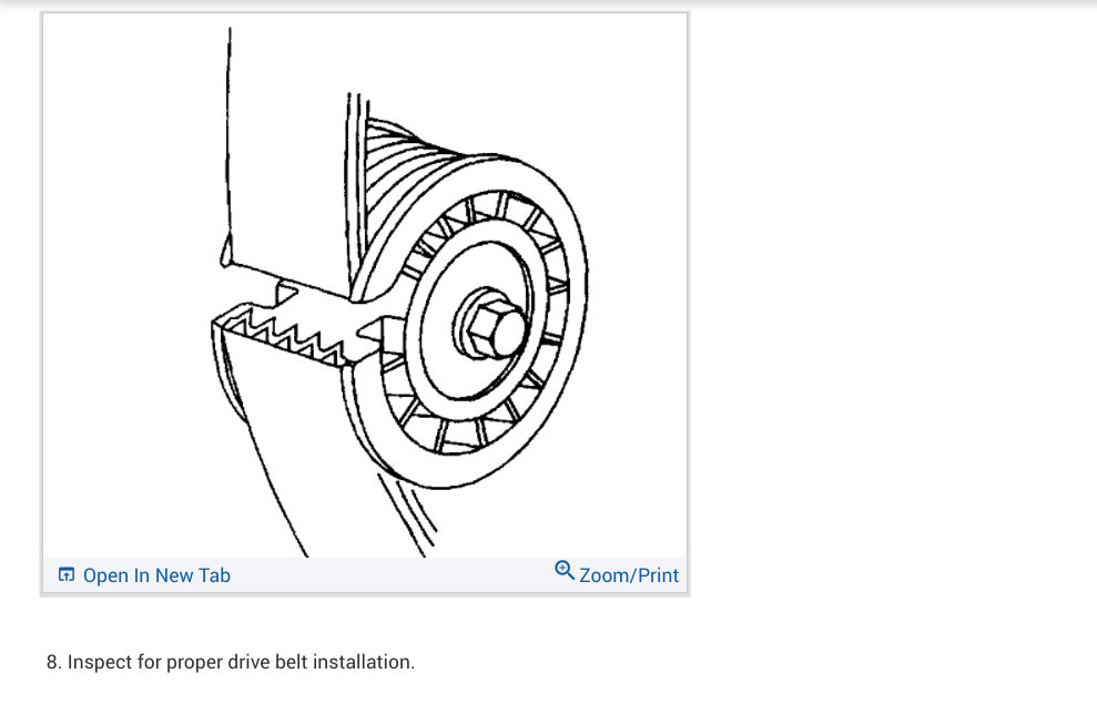

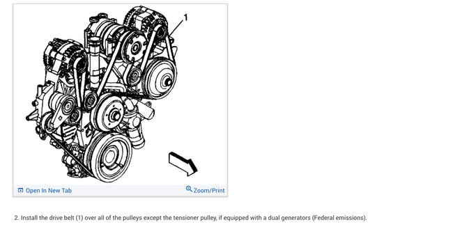

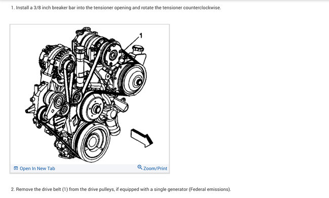

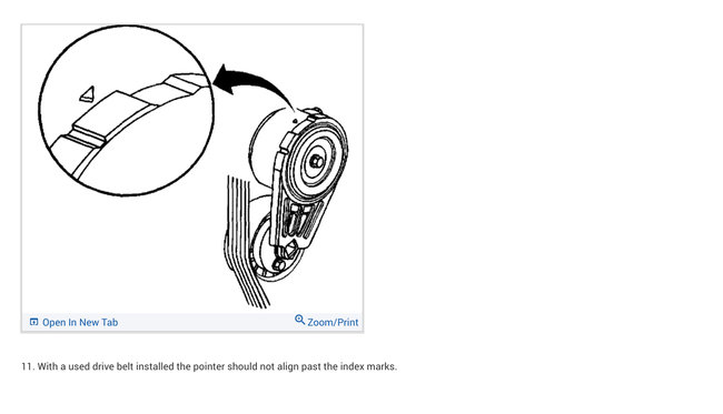

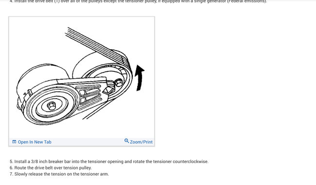

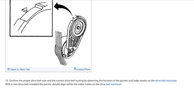

Installation Procedure
1. Install the drive belt.
2. Route the drive belt over and/or around all the drive pulleys except for the tensioner.
3. Install a 3/8 inch breaker bar into the tensioner opening and rotate the tensioner counterclockwise.
4. Install the belt over and/or around the tensioner.
5. Slowly release the tension on the tensioner arm.
6. Inspect the drive belt for proper installation on and/or around all pulleys.
7. Position the engine cooling fan shroud on the 3 mounting brackets (1).

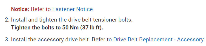

Bolt on serpentine tensioner pulley wont come out turns either way.
DANNY L
  • 5,648 POSTS
Hello, I'm Danny.
If the pulley bolt is stripped you will have to remove the whole assembly to replace. Here are a few tutorials to view showing how to replace the serpentine belt and tensioner:
https://www.2carpros.com/articles/serpentine-belt-tensioner-replacement
I've attached picture steps below on how to remove and replace both the serpentine belt and the tensioner for your truck. Hope this helps and thanks for using 2CarPros.

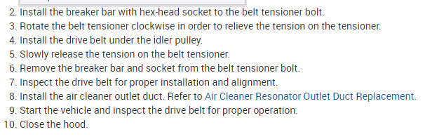

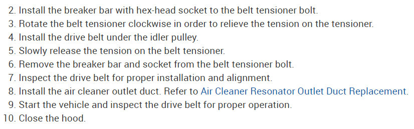

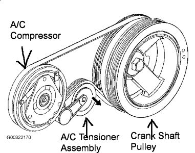

ELIZABETH BURKEEN
my truck need to have the serpentine belt replaced I need to save money so I want to do it myself.
Feb 24, 2021 at 4:54 AM (Merged)
  • 110,244 POSTS

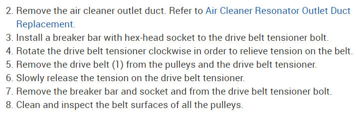

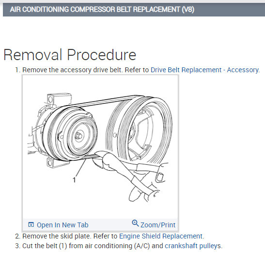

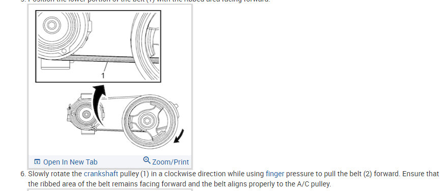

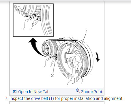

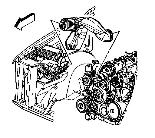

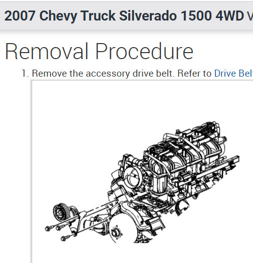

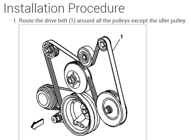

Replacing the serpentine belt isn't a difficult job. First, here is a link that explains in general how it's done. You can use this as a guide.
Here are the directions specific to your vehicle. The attached pics correlate with the directions.
________________________________________
2005 Chevy Truck Silverado 1500 4WD V8-5.3L VIN B
Drive Belt Replacement - Accessory
Vehicle Engine, Cooling and Exhaust Engine Drive Belts, Mounts, Brackets and Accessories Drive Belt Service and Repair Procedures Drive Belt Replacement - Accessory

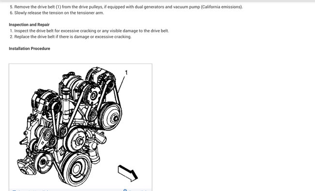

DRIVE BELT REPLACEMENT - ACCESSORY
Drive Belt Replacement - Accessory (4.8L, 5.3L, and 6.0L Engines)

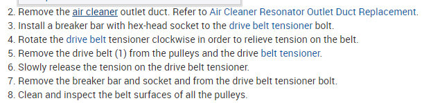

Removal Procedure
pic 1
1. Loosen the air cleaner outlet duct clamps at the following locations:
^ The throttle body
^ The Mass Airflow/Intake Air Temperature (MAF/IAT) sensor
2. Disconnect the radiator inlet hose clip from the outlet duct.
3. Remove the air cleaner outlet duct.
pic 2
4. Install a breaker bar with hex-head socket to the drive belt tensioner bolt.
5. Rotate the drive belt tensioner clockwise in order to relieve tension on the belt (1).
6. Remove the belt (1) from the pulleys and the drive belt tensioner.
7. Slowly release the tension on the drive belt tensioner.
8. Remove the breaker bar and socket and from the drive belt tensioner bolt.

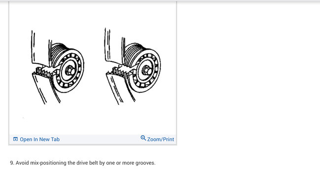

9. Clean and inspect the belt surfaces of all the pulleys.

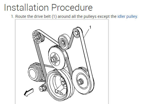

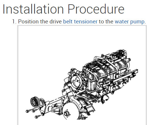

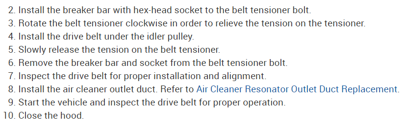

pic 3
1. Route the drive belt (1) around all the pulleys except the idler pulley.
2. Install the breaker bar with hex-head socket to the belt tensioner bolt.
3. Rotate the belt tensioner clockwise in order to relieve the tension on the tensioner.
4. Install the drive belt (1) under the idler pulley.
5. Slowly release the tension on the belt tensioner.
6. Remove the breaker bar and socket from the belt tensioner bolt.
7. Inspect the drive belt (1) for proper installation and alignment.

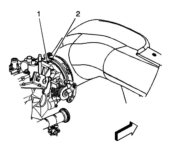

pic 4

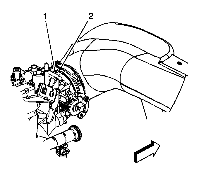

8. Align the arrow (2) at the throttle body end of the duct with the throttle body attaching stud (1).

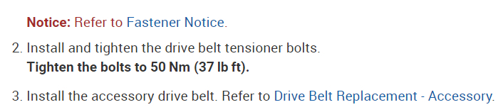

pic 5
9. Install the air cleaner outlet duct.
10. Connect the radiator inlet hose clip to the outlet duct.
Notice: Refer to Fastener Notice in Service Precautions.
11. Tighten the air cleaner outlet duct clamps at the following locations:
^ The throttle body
^ The MAF/IAT sensor
Tighten the clamps to 4 Nm (35 inch lbs.).

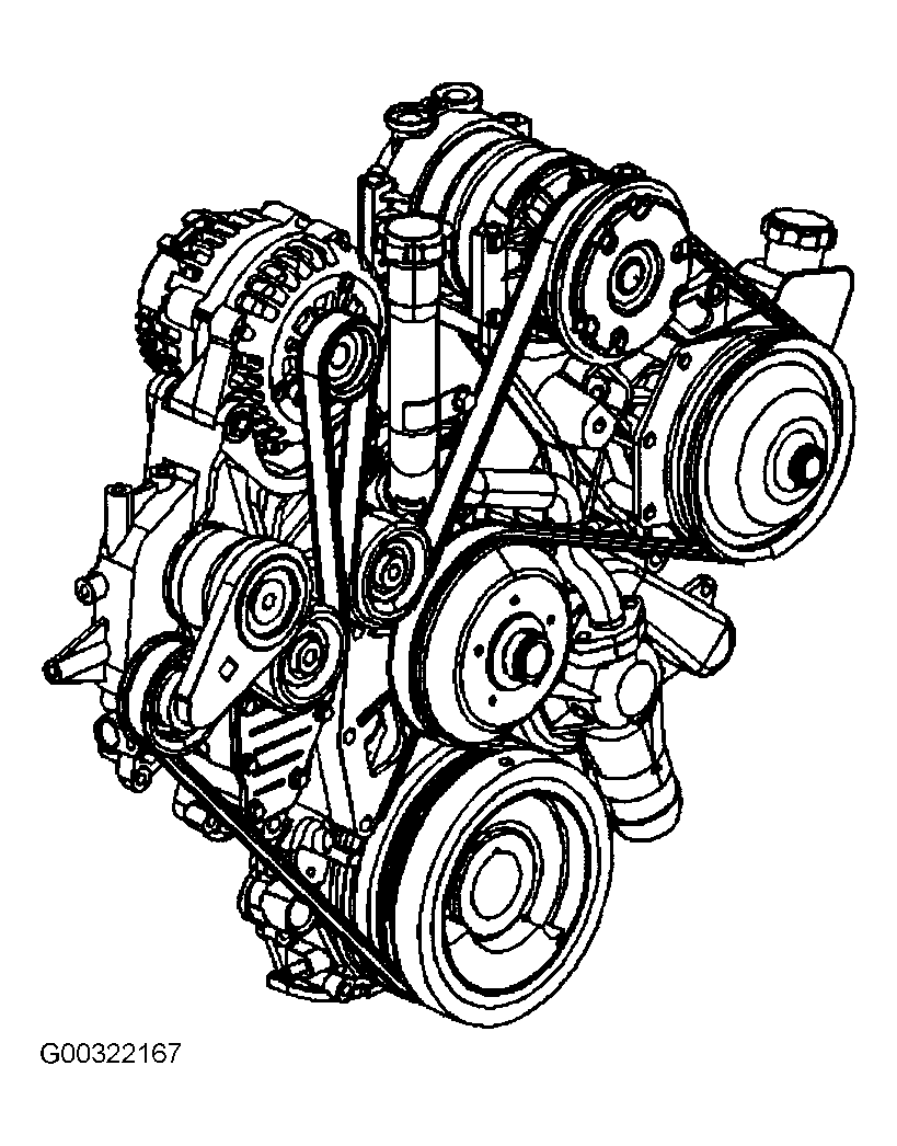

JOELROSS
V8 four wheel drive automatic 191,000 miles.
How do i tighten up my belt? my buddy told me that was why i was hearing a squealing noise when my engine is running, idle or revved.
OBXAUTOMEDIC
  • 3,711 POSTS
You cannot tighten the belt it has an automatic tension-er on it.
But before you go ant replace it here it something to try.
Find the location of your tension-er pulley and your idler pulley then with a spray lube and the engine off spray the center bolt of one of the pulleys. Then start the vehicle. If noise is gone for short time then the bearings are going back and you will need to replace that pulley. If noise is still there then turn vehicle off and spray other pulley in same manner and restart if noise is gone for short time replace that pulley. While doing this also watch the tension-er assembly for excessive movement. Also, when was the last time you replaced the belt? An old worn belt can cause the squealing also.
If you need diagram will need more info on you truck.
Is it a 1500, 2500 etc and is it 4x4 or not and engine size in liters.

JOELROSS
1500 ext cab lb, 4x4, 5.3 L v8.
OBXAUTOMEDIC
  • 3,711 POSTS
Here are the diagrams:
https://images.2carpros.com/forum/automotive_pictures/188069_03silvr1500_53_serpbeltroute_1.jpg
https://images.2carpros.com/forum/automotive_pictures/188069_03silvr1500_53_acbeltroute_2.jpg

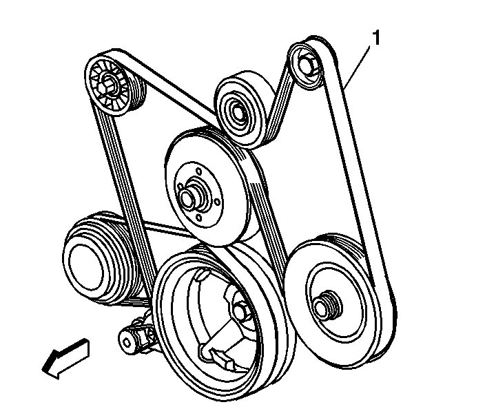

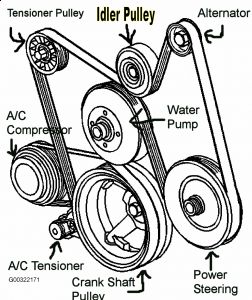

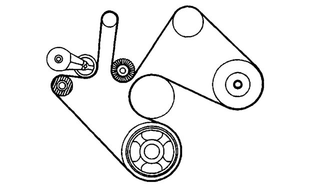

ADAMKUNZ
how do i find a belt diagram for a chevy silverado 2500 6.6 hd duramax

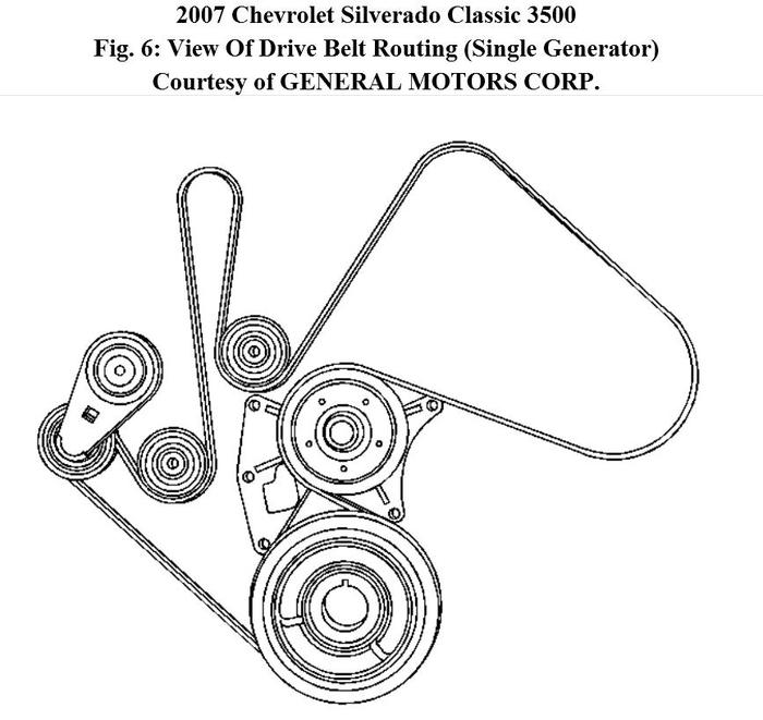

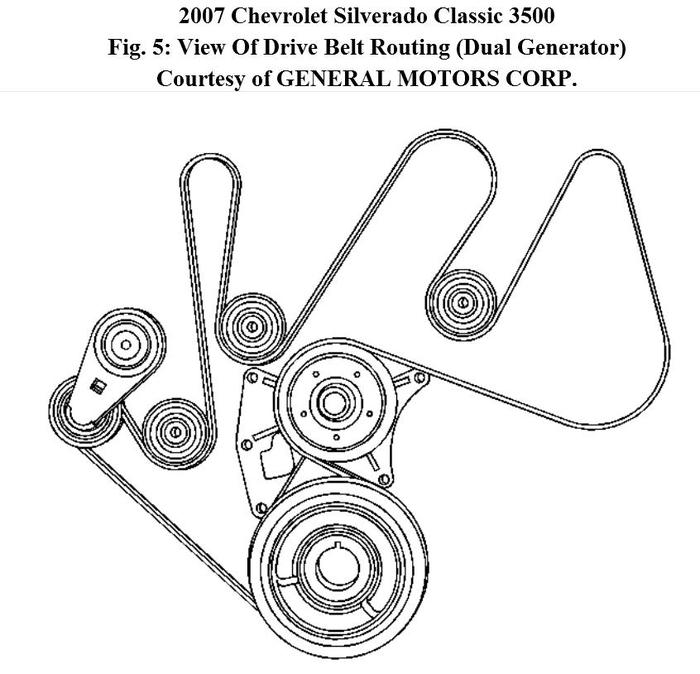

PROTECH1980
  • 901 POSTS
heres a pic
PROTECH1980
  • 901 POSTS
Thats federal emissions with single alr/ let me know if dual alternater/or califirnia emissions.

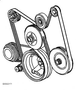

JEB77
2003 Chevy Silverado V8 Two Wheel Drive Automatic
What is the fan belt routing on this truck?
Feb 24, 2021 at 4:55 AM (Merged)
BLUELIGHTNIN6
  • 16,542 POSTS
ok cool, here is for future reference
https://images.2carpros.com/forum/automotive_pictures/261618_Graphic_402.jpg
JEB77
thanks for the help...i cant believe they dont put a diagram in the owners manual cuz after all these years the one under the hood is not completely legible...so thanks again...

TREEGUY
Having alot of trouble reattaching the serpentine belt
back on a new alternator, is there a trick to it
Feb 24, 2021 at 4:56 AM (Merged)
MERLIN2021
  • 17,250 POSTS
You need to get it all lined up and ready to slip onto your last pulley, some tensioners (GM) usually have a 1/2 square hole in the tensioner arm to put a 1/2 drive ratchett into, some dont, if it does, use the ratchet and apply force to the tensioner test it by pushing both ways, it will move to loosen only as tension is always applied, push to release the tension as you slip the belt on, if no square hole, use a box end wrench and apply the force on the hex head in the middle of the pulley. I use two wrenches together to get more leverage.
Slip the opened end of the wrench that fits on the tensioner into the box end of the extra wrench.

I am getting set to change the belts on my chevy and I found the tensioer for the AC belt, but I don't see one for the serpentine belt. I cant get the belt tension loose enough to get it off. What am I missing?
Thanks
KENVCR
  • 105 POSTS
Should be located in front of your water pump or closer to the alternator. 2inch round, with a 5/8" nut in centre. Spring loaded, you want to pull up on it to release tension on belt. Attach a long handle ratchet and use that to turn to ease up the tension.
