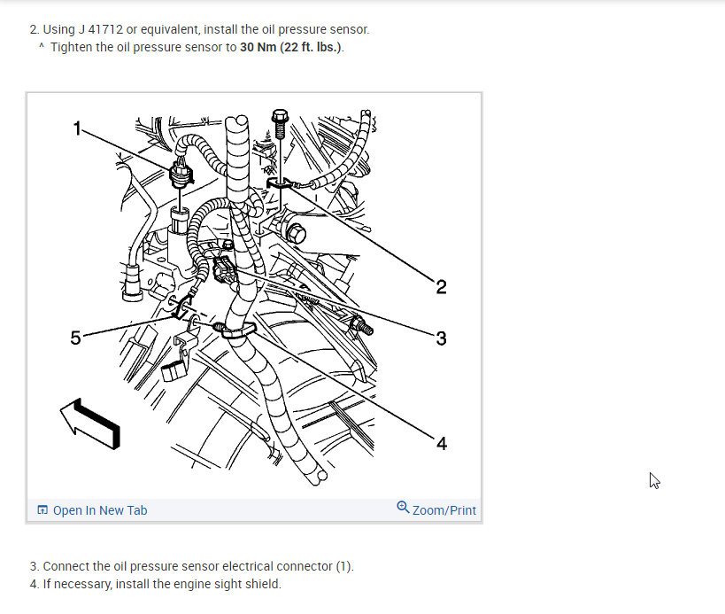

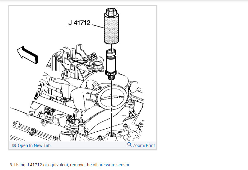

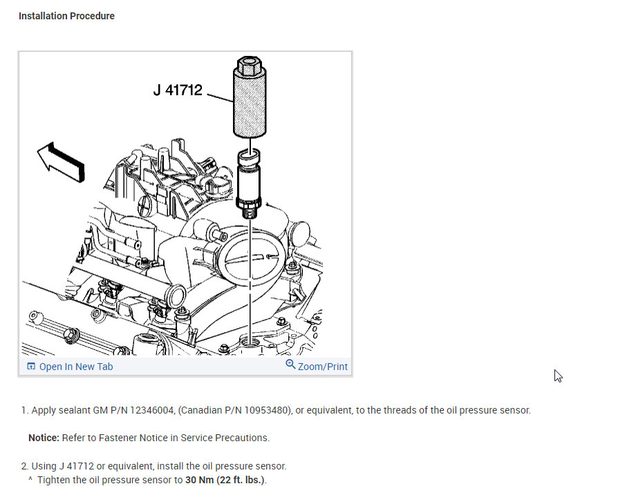

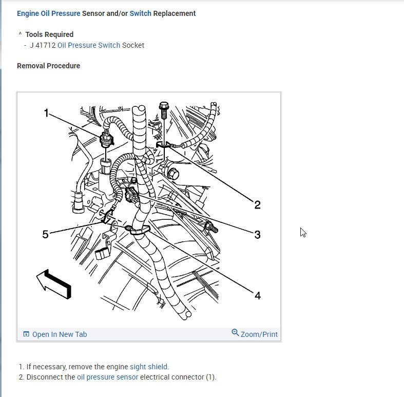

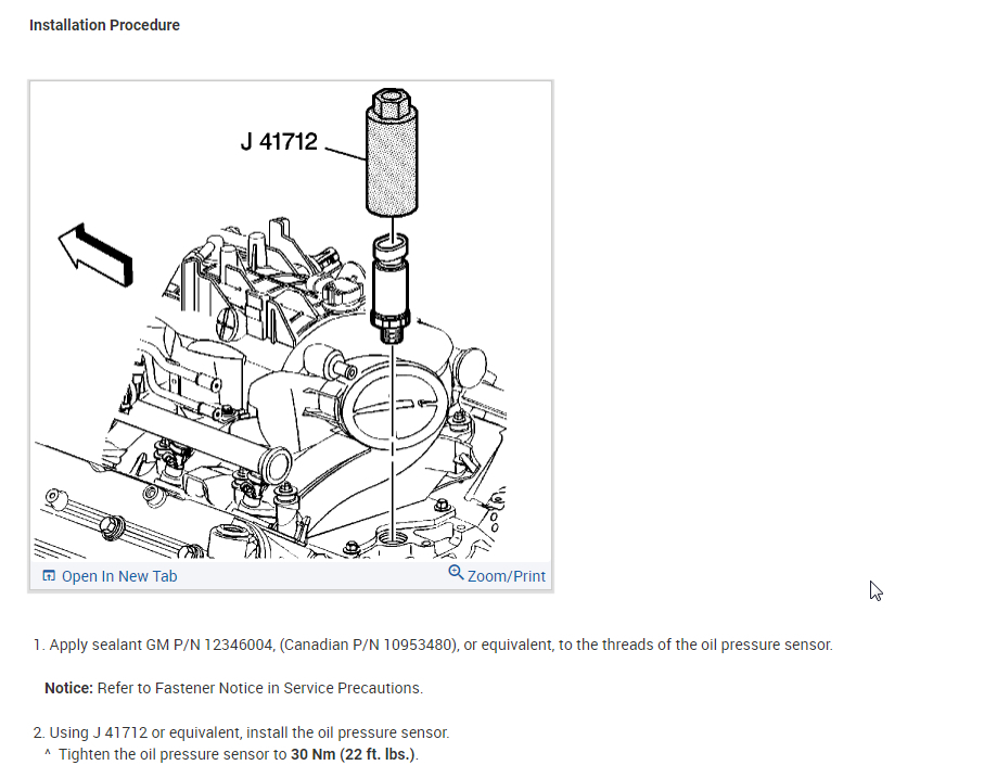

I attached below the process on how to change the sensor if the mechanical gauge shows the pressure is not high. Let us know if you have questions. Thanks
