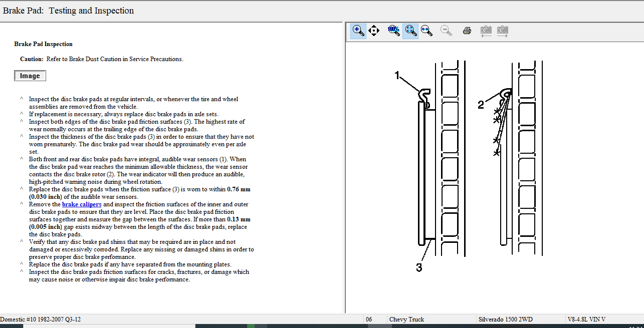

Brake pad and rotors are squeaking bad when I stop

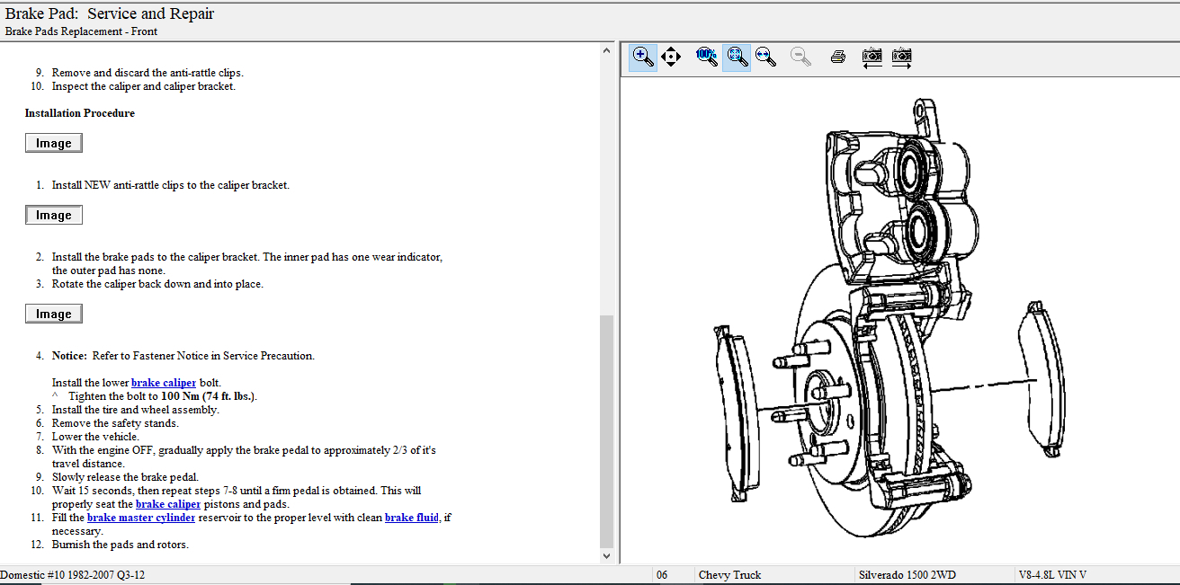

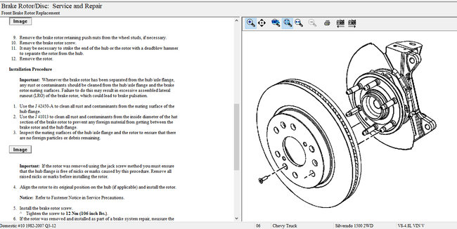

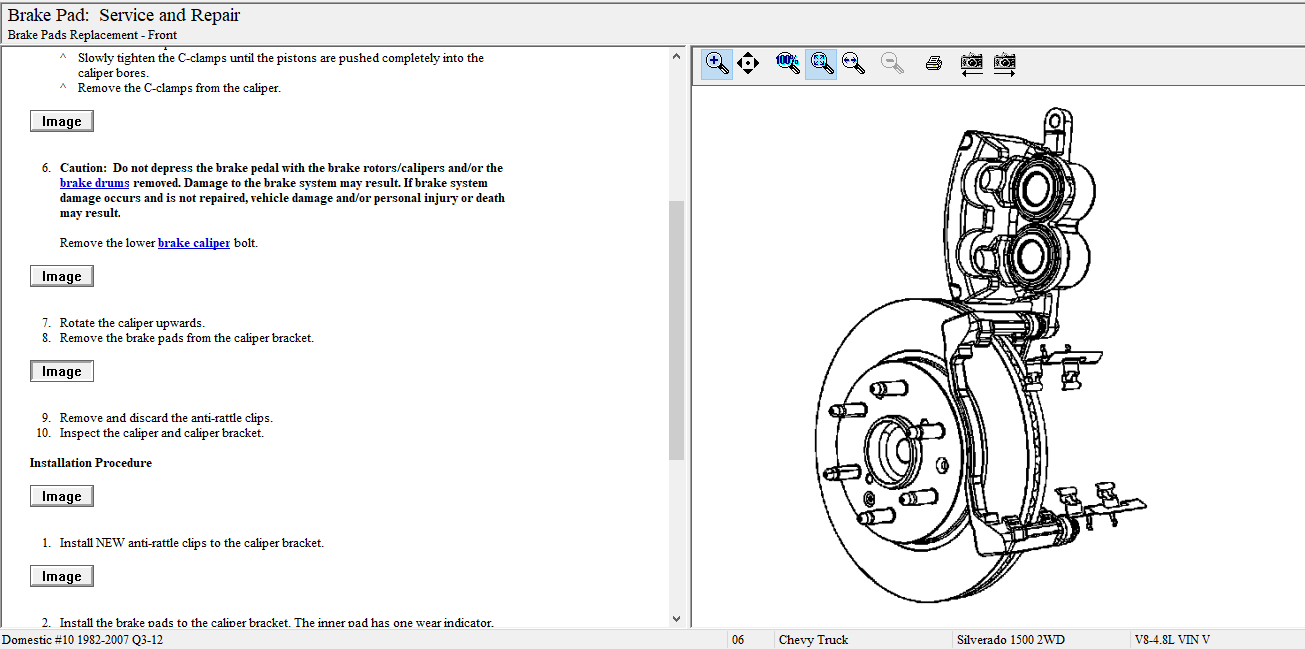

Can you help me do brake job on my truck? I cant stand the noise.
Saturday, March 13th, 2010 AT 4:54 AM
SEVAG P
  • 405 POSTS
Hello.

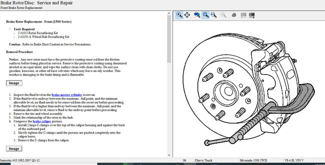

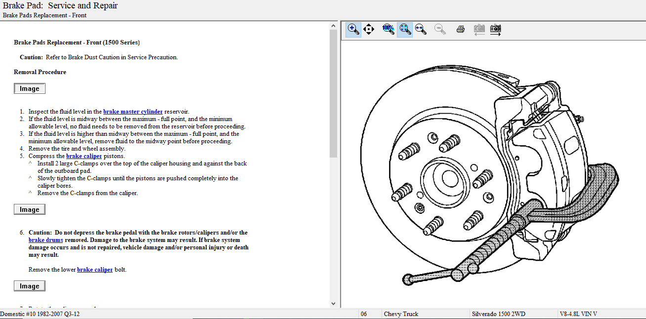

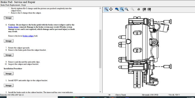

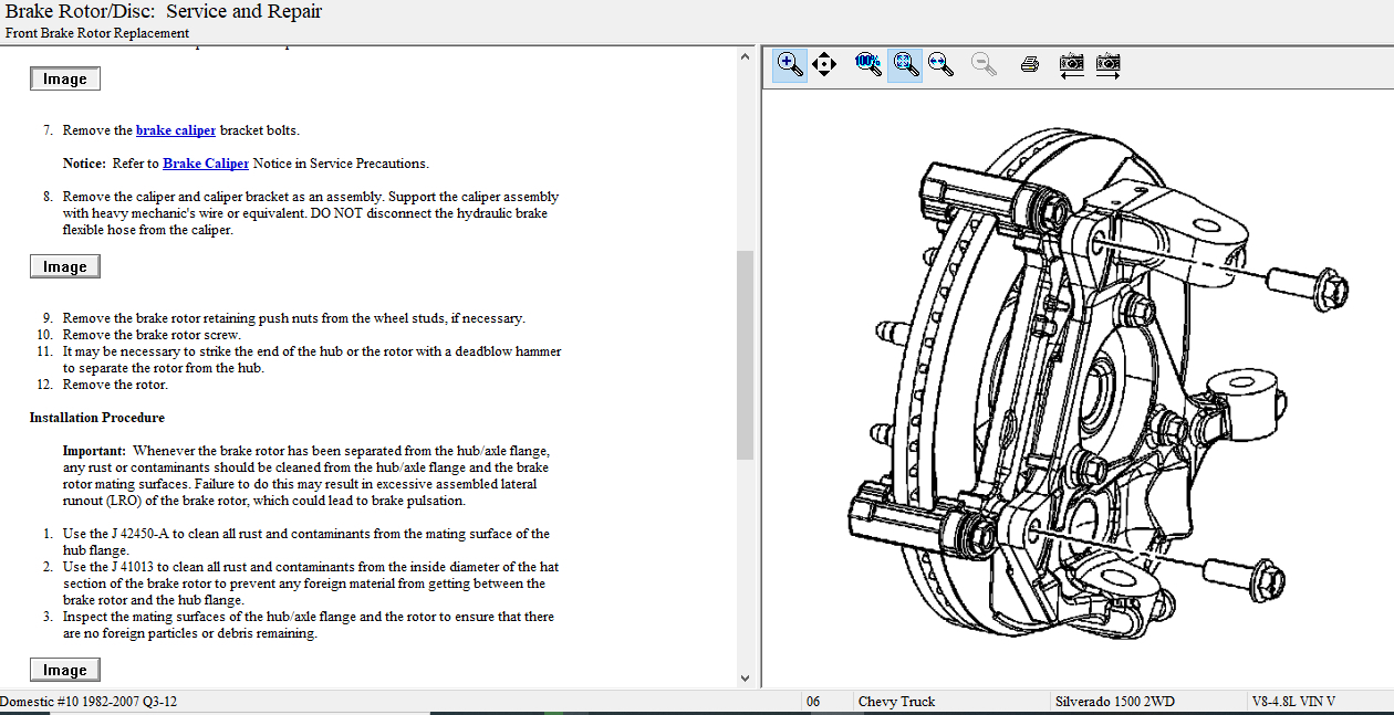

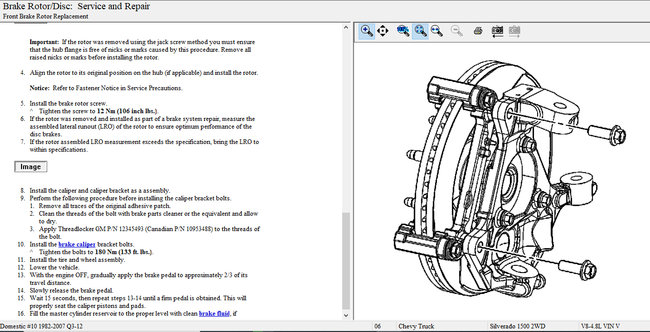

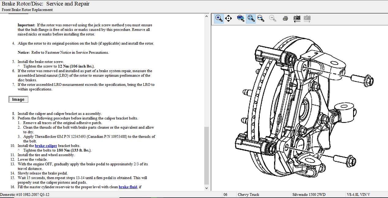

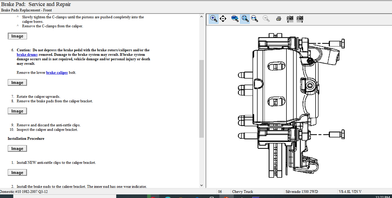

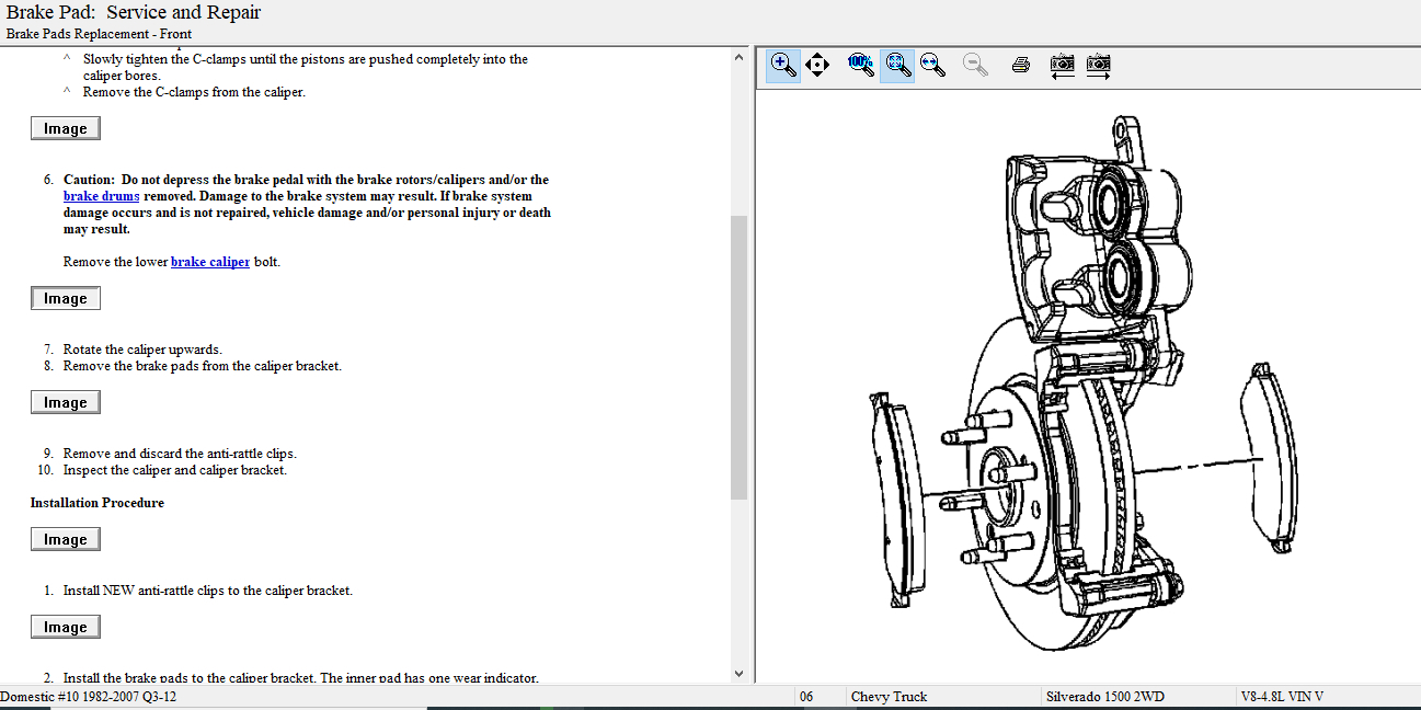

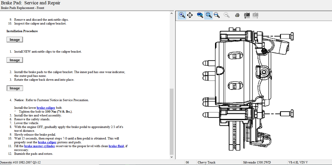

Just follow the steps you can do the job by yourself. check our link below how to replace front pads and discs. check our link below video how to replace brake pads and discs,
https://youtu.be/cFwjBwhpZ4o
and

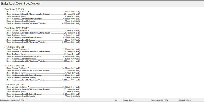

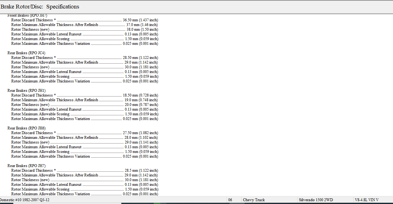

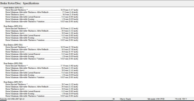

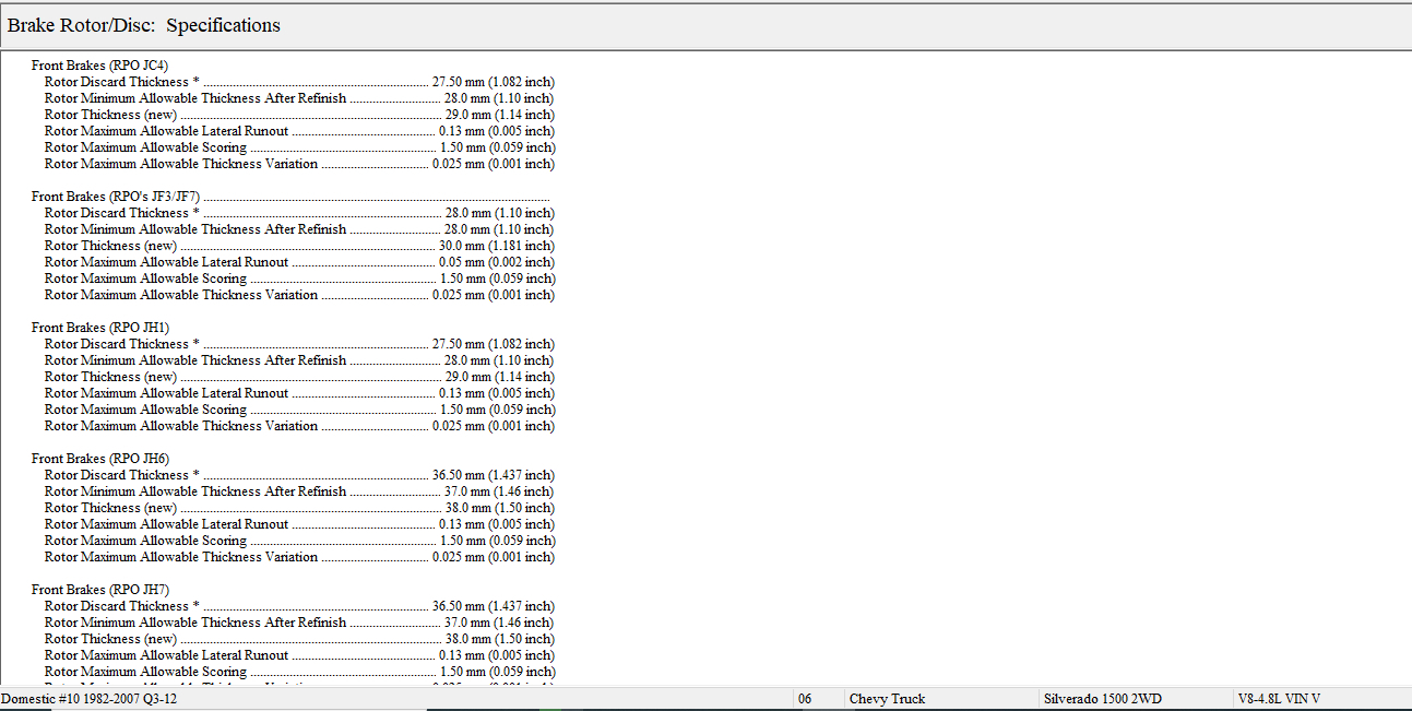

Check the diagrams below how to replace front pads and discs, and the measurement values for discs.
