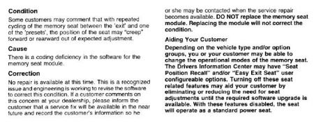

2004 Chevy Silverado V8 Four Wheel Drive 81000 miles
The power seats have started, just today, working in reverse of how they should. The seat is moving forward as I turn the truck off. It used to move backwards to make it easier to get out. I have also noticed that to adjust the seat, you have to move the button in the opposite direction than you should. (Push it back to move the seat forward). What do I do?
Wednesday, March 25th, 2009 AT 12:18 PM
JDL
  • 16,098 POSTS
https://www.2carpros.com/forum/automotive_pictures/170934_memory_seat_1.jpg
I came across the above bulletin, if it fits your situation? I also saw a revised bulletin, where the dealer can now reprogram the memory seat module, if that would fix the problem.
