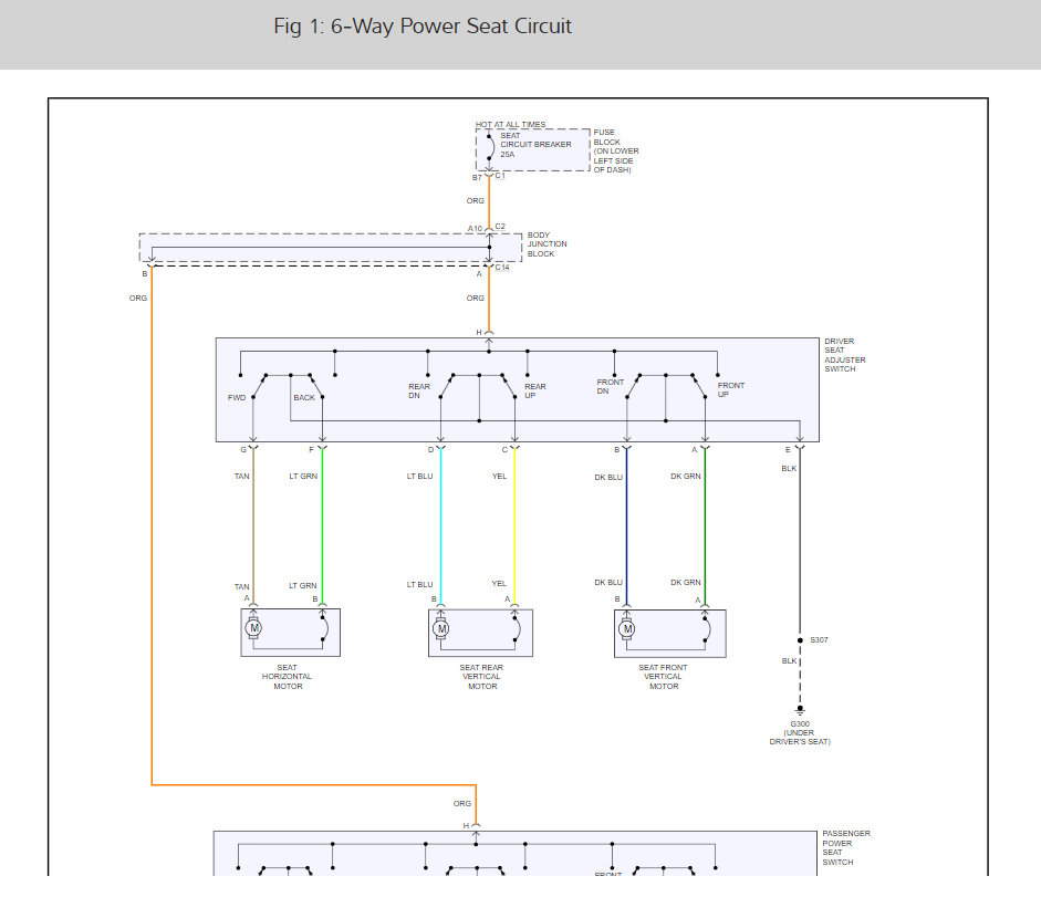

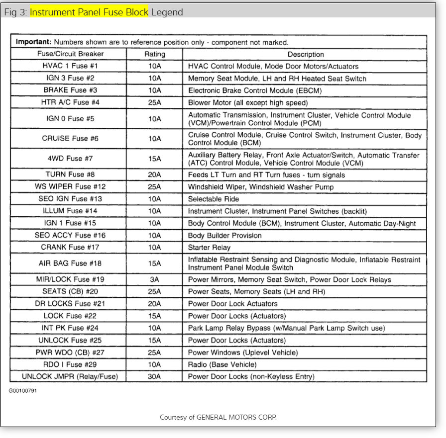

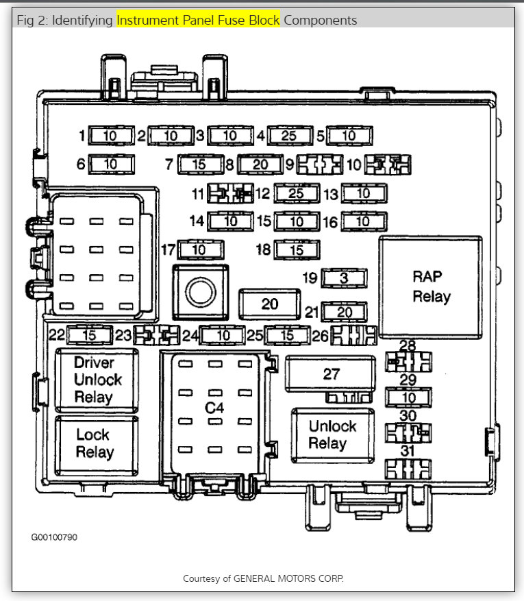

What fuse control's the the power seats and where is it located?
Feb 15, 2016 at 11:29 AM
HMAC300
  • 48,601 POSTS

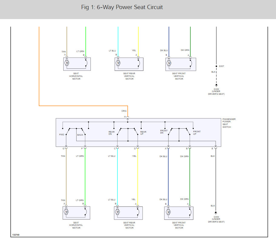

there is no fuse it's a circuit breaker on fuse box left side of dash. Here is a guide to help check for power and the seat wiring diagrams so you can see how they work with the fuse location as well.
