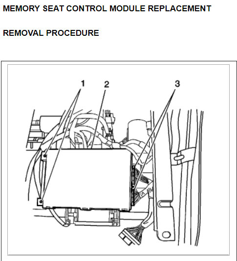

i have a 2003 Silverado and the odometer says unknown driver the truck will not start and the windows will not go up or down and the doors will not lock the gauges appear to be low what caused that to happen and how do you repair that.

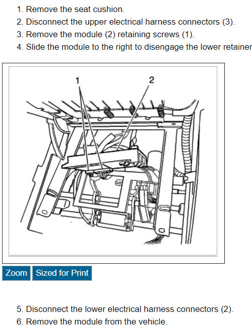

This happens when the seat module goes out for the driver seat. The module is located under the seat here are diagrams to show you how to fix the problem. Can also be caused by moisture in the connector, be sure to check that when you have it apart Check out the diagrams (Below). Please let us know if you need anything else to get the problem fixed.
