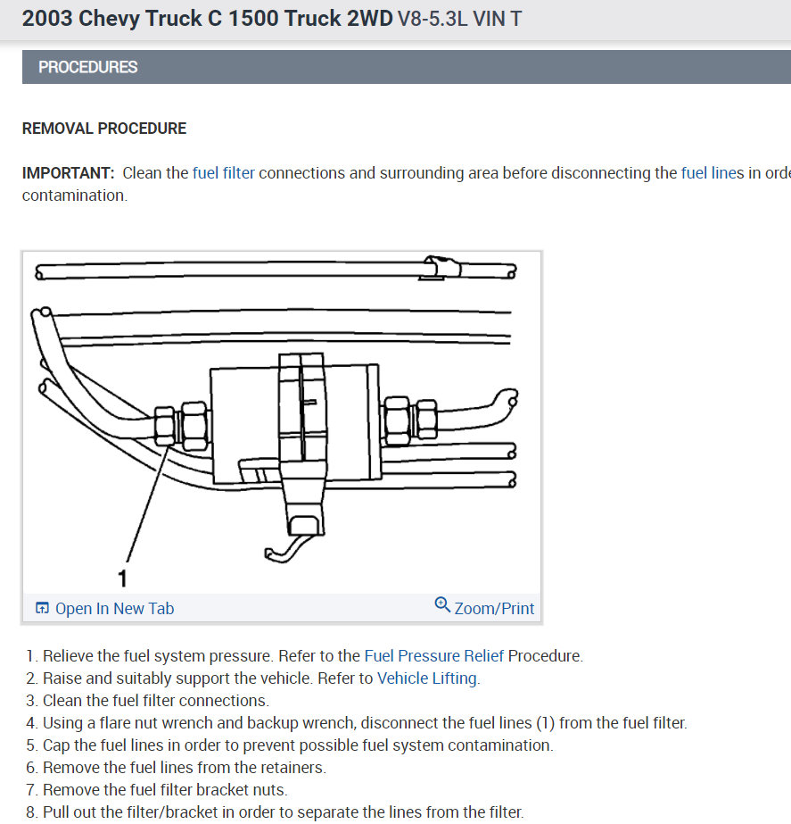

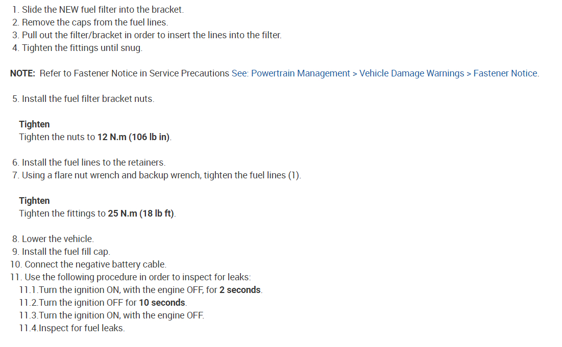

i cannot locate where canister fuel filter is ,I know on older chevys its on the inside of either the rright or left frame rail. any info is appreciated, this is a threaded fittings on both ends filter can, thanks

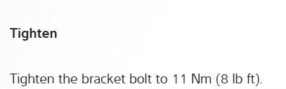

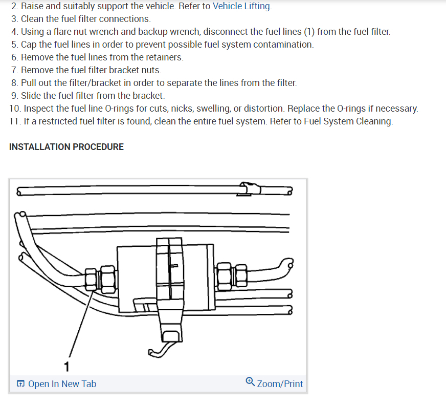

The fuel filter is on the driver side frame rail the instructions for changing it are in the diagrams below along with a guide to help walk you through the steps.
https://www.2carpros.com/articles/how-to-change-a-fuel-filter

It went on fine just keeps spinning i do not know what to do. do i need to take the housing off and break the new filter off?
Sep 10, 2020 at 12:17 PM (Merged)
HMAC300
  • 48,601 POSTS
if it is not leaking don't worry about it , it should mount in a bracket on frame. also, have you left connectors out or o-rings.
RONNIE HOOVER
I fixed lol. it was not threaded on right.

I am changing my fuel filter. How do I release the pressure in my fuel line? Do I need to pull a certain fuse?
Sep 10, 2020 at 12:18 PM (Merged)
KONIK20
hi
pull out fuel pomp fuse,start car,wait until it stops running,there is no pressure now in fuel line, u can work on fuel filter now.

Can anyone tell me how to replace the fuel filter on my 2001 Silverado? Do I need a special tool to remove the filter and do I need to take the pressure out of the fuel line? Can I take my chances by not relieving the fuel pressure before removing the old fuel filter?

yes some for sure depending on the truck had a special tool. some didnt. some you could just use wrenchs. as for fuel pressure, i would for SURE relieve the fuel pressure. TRUST ME relive the fuel pressure.

the safest way to do it is pull the fuel pump relay and start the vehicle and let it run the rest of the fuel out of the system. then you will be ready.

If its not in the fuel tank, its in a clip on the inside edge of the frame rail, just about under the drivers seat.

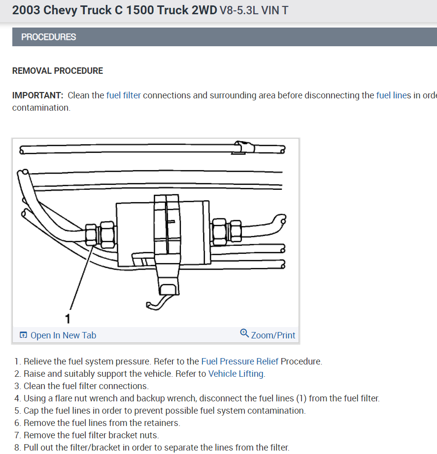

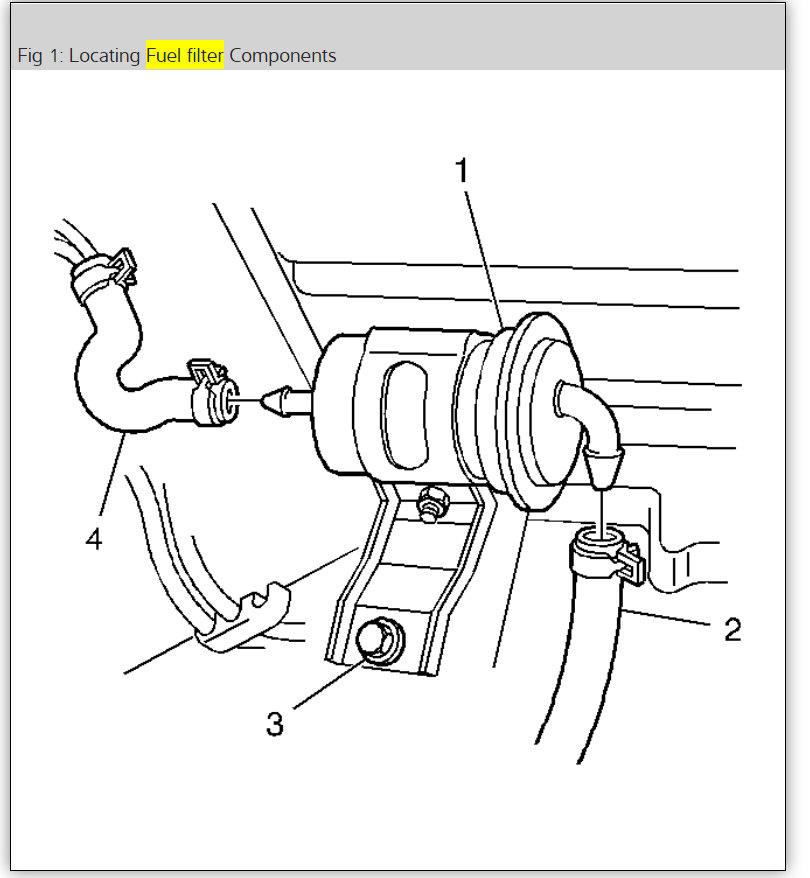

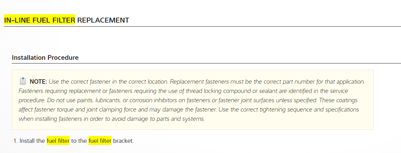

SCGRANTURISMO
  • 4,897 POSTS
I have included the information you requested in the diagrams down below. Let us know if there anything else that we can help you with.

Just make sure no fuel pressure on the system before taking any fuel lines loose. Usually after the vehicle sets overnight without the key being cycled there is not much pressure, but, you still need to be aware. Use a catch pan, gas will probably run out of the lines, if too much gas, plug the line until you go back with new filter. Do not work on it in an enclosed area, where there might be a pilot light lit somewhere. If arrow on filter, arrow points to front of vehicle.
Usually with my size, I do not have to raise and support the vehicle to get at the filter, if you do have to raise and support the vehicle, be safe, there are safety issues working under any vehicle.
At the top of page, vehicle repair guides, link. A lot of good information.

Welcome to the forum. Under the vehicle, driverside frame-rail, close to tank. Looks like threaded fitting on both ends. Make sure no pressure on system, before taking anything loose. If too much gas tries to run out of lines after filter removal, I plug the lines till ready with new filter, Don't forget to unplug lines. If you loosen the cap, it may or may not help, gas trying to drain. If you use a drop-lite, don't lay it where gas might drain on it.
