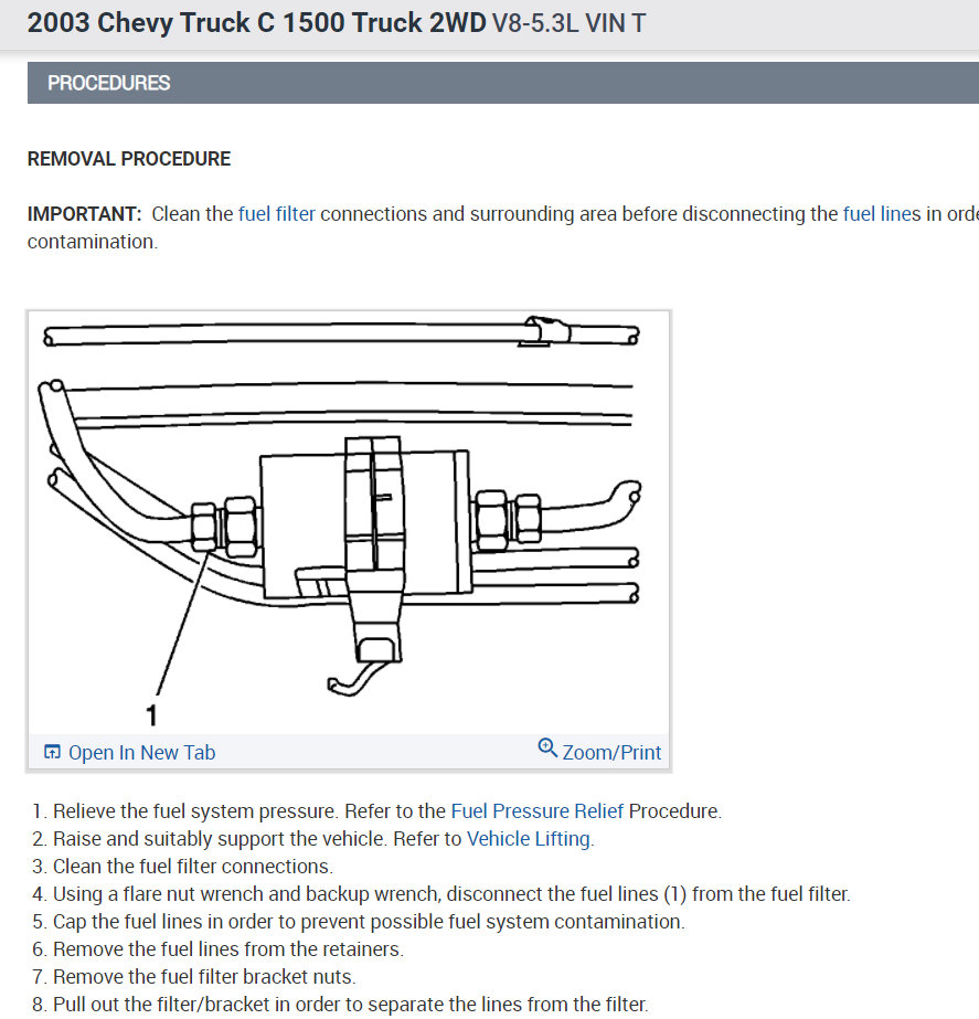

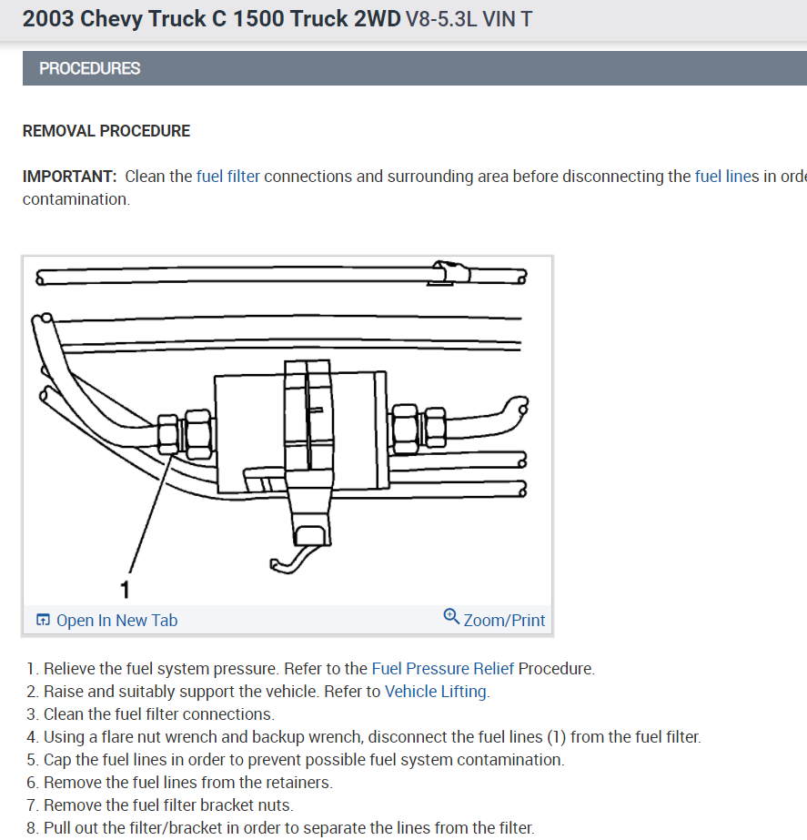

Under vehicle, driver side, below seating area, near fuel tank, mounted on frame rail in fuel line. This guide should help with instructions in the diagrams below to show you how on your truck.
https://www.2carpros.com/articles/how-to-change-a-fuel-filter

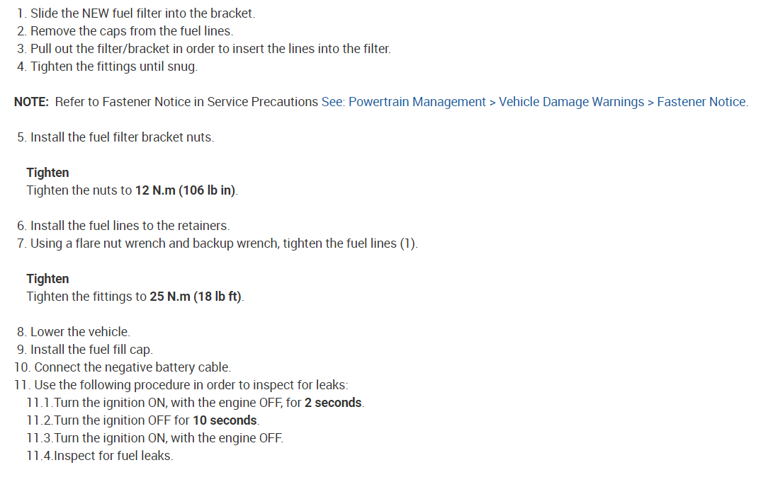

Need to know how to reduce the pressure before I change the inline fuel filter, and how to change the fuel filter
Sep 10, 2020 at 5:24 AM (Merged)
JDL
  • 16,098 POSTS

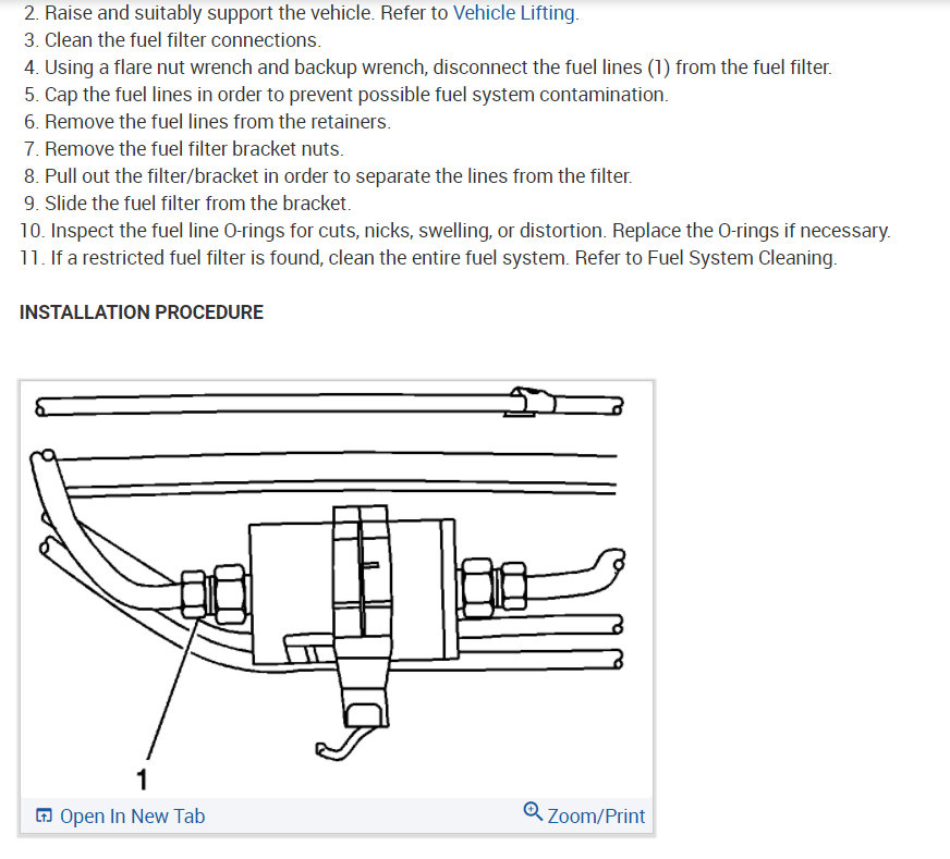

https://images.2carpros.com/forum/automotive_pictures/170934_97_fuel_filter_1.jpg
driverside frame rail, Threaded fitting on both ends, need a couple of wrenches. As far as pressure, after the vehicle sits overnight without the key being cycled or engine started, there usually isn't much pressure. A fuel pressure gage has a bleedoff valve on it, bleed into a container, or make sure the pump is disconnected, start the the vehicle, when it dies the pressure should be gone. That doesn't mean gas won't drain from the lines, take gas cap off. Sometimes I'll plug the gas lines with something till ready to go back with new filter. If you use a droplite don't lay it where gas might drip on it.

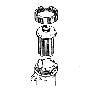

1996 Chevy Truck K 3500 Truck 4WD V8-6.5L DSL Turbo VIN F Fuel Filter Part 1
https://images.2carpros.com/forum/automotive_pictures/12900_ffc1_1.gif
Fuel Filter Part 2
https://images.2carpros.com/forum/automotive_pictures/12900_ffc2_1.gif
Fuel Filter Part 3
https://images.2carpros.com/forum/automotive_pictures/12900_ffc3_1.gif
The fuel filter is attached to the front of the intake manifold between the first two runners.
