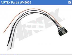

https://images.2carpros.com/forum/automotive_pictures/170934_harness_1.jpg
I believe the wiring harness for the fuel pump is a four wire connector. There may be also a three wire connector for the fuel tank pressure sensor. The sensor uses a 5 volt reference. I can't tell what connector you were testing? I won't be back till tomorrow. goodluck

The connector I checked was the one with three contacts in line. I think the wires on the ends were black and gray and the gray one had 5 volts which increased to about 5.2 volts when I cranked the engine. Battery voltage is 12.2 v and that is what I get when I check the 30 connection to the fuel pump relay. So, I am guessing that I should get close to battery voltage on the connector that drives the fuel pump right?
I will go back today and check the other connector which is square and has 4 contacts.Also the picture isn't real clear, that one would seem to be the one you sent the picture of. I have also read that there is a connector between the cab and bed. I will check that out for corrosion.
