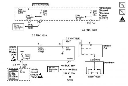

unless you check the fuel pressure,you are chasing your tail.most of the symptoms you described are fuel pressure related.As for the injector cleaning,it takes some rather expensive equipment to do the procedure to un-stick the poppets.
Oct 3, 2007 at 3:15 PM
CORVETTE73
  • 12 POSTS

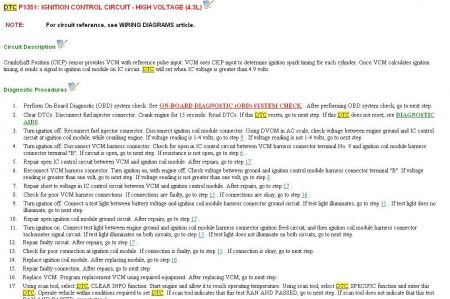

going to check the fuel pressure tonight after work. It didn't want to start this morning but after a couple trys it took off. It also brought up another code. A P1351 code, which is a misfire. I didn't have time to check the freeze frame, but will later. I have access to the equipment used to clean the poppets, but don't want to go to that extreme until all other avenues are exhuasted, if ya know what I mean. Thanks guys, for the help and I'll keep updated!
Oct 4, 2007 at 2:13 AM
DENNYP
  • 1,824 POSTS
DTC P1351 Ignition Coil Control Circuit High Voltage Circuit Description The enhanced ignition system uses the crankshaft position (CKP) sensor in order to provide a timing input to the control module. Ignition control (IC) spark timing for each cylinder is based on this input. The control module provides the ignition timing signal to the ignition control module (ICM) to control the ignition coil. Each timing pulse detected by the ICM allows it to energize the ignition coil. A large secondary ignition voltage is induced in the secondary coil by the primary coil. This high voltage is switched to the correct spark plug by the distributor. This diagnostic trouble code (DTC) will set if the vehicle control module (VCM) detects an unusually high voltage on the ignition timing signal circuit. Conditions for Running the DTC The ignition control is enabled. The engine speed is less than 250 RPM. Conditions for Setting the DTC The ignition control voltage is more than 4.9 volts. Action Taken When the DTC Sets The control module illuminates the malfunction indicator lamp (MIL) the first time the diagnostic runs and fails. The control module will set the DTC and records the operating conditions at the time the diagnostic fails. The control module stores the failure information in the scan tools Freeze Frame/Failure Records. Conditions for Clearing the MIL or DTC The control module turns OFF the MIL after 3 consecutive drive trips when the test has run and passed. A history DTC will clear if no fault conditions have been detected for 40 warm-up cycles. A warm-up cycle occurs when the coolant temperature has risen 22°C (40°F) from the startup coolant temperature and the engine coolant reaches a temperature that is more than 70°C (158°F) during the same ignition cycle. Use a scan tool in order to clear the DTCs. Diagnostic Aids Intermittent test -- If the connections and the harness check OK, monitor a digital voltmeter connected between VCM terminal C3 pin 9 and C4 pin 18 while moving related connectors and wiring harnesses. If the failure is induced, the voltage reading will change. This may help to isolate the location of the malfunction. An intermittent may be caused by any of the following conditions: A poor connection Rubbed through wire insulation A broken wire inside the insulation Thoroughly inspect any circuitry that is suspected of causing the intermittent complaint. Refer to Testing for Intermittent and Poor Connections in Wiring Systems. If a repair is necessary, refer to Wiring Repairs or Connector Repairs in Wiring Systems. Test Description The numbers below refer to the step numbers on the diagnostic table. This test determines if the DTC is an intermittent. This step checks if the IC signal from the VCM is available at the ignition control module. Step Action Value(s) Yes No 1 Did you perform the Powertrain On-Board Diagnostic (OBD) System Check. -- Go to Step 2 Go to Powertrain On Board Diagnostic (OBD) System Check 2 Clear the DTCs. Disconnect the injector connector. Crank the engine for 15 seconds. Does DTC P1351 set? -- Go to Step 3 Go to Diagnostic Aids 3 Turn OFF the ignition. Reconnect the injector connector. Disconnect the ignition control module harness connector. Probe the ignition control module harness connector terminal B with a DMM connected to a ground. With the DMM set to the AC scale, crank the engine. Monitor the voltage reading. Is the voltage reading within the specified value? 1-4 V Go to Step 9 Go to Step 4 4 Turn OFF the ignition. Disconnect the VCM C3 connector. Check for an open in the IC control circuit between the VCM C3 connector pin 9 and the ignition control module harness connector terminal B with a DMM. Did you find a problem? -- Go to Step 5 Go to Step 6 5 Repair the open IC circuit between the VCM and the ignition control module. Refer to Wiring Repairs in Wiring Systems. Is the action complete? -- Go to Step 17 -- 6 Reconnect the VCM C3 connector. Turn ON the ignition, leaving the engine OFF. Probe the ignition control module harness connector terminal B with a DMM connected to a ground. Is the reading more than the specified value? 1.0 V Go to Step 7 Go to Step 8 7 Repair the short to voltage in the IC control circuit between the VCM and the ignition control module. Refer to Wiring Repairs in Wiring Systems. Is the action complete? -- Go to Step 17 -- 8 Check for poor VCM connection. Did you find a problem? -- Go to Step 15 Go to Step 16 9 Turn OFF the ignition. Probe the ignition control module harness connector terminal C with a test lamp connected to B+. Is the test lamp ON? -- Go to Step 11 Go to Step 10 10 Repair the open ignition control module ground circuit. Refer to Wiring Repairs in Wiring Systems. Is the action complete? -- Go to Step 17 -- 11 Turn ON the ignition, leaving the engine OFF. Probe the ignition control module harness connector terminal A with a test lamp connected to a ground. Is the test lamp ON? -- Go to Step 13 Go to Step 12 12 Repair the open in the ICM ignition positive voltage circuit. Refer to Wiring Repairs in Wiring Systems. Is the action complete? -- Go to Step 17 -- 13 Check for a poor ignition control module connection. Did you find a problem? -- Go to Step 15 Go to Step 14 14 Replace the ignition control module. Refer to Ignition Coil and ICM Replacement in Engine Electrical. Is the action complete? -- Go to Step 17 -- 15 Repair the circuit as necessary. Refer to Connector Repairs or Wiring Repairs in Wiring Systems. Is the action complete? -- Go to Step 17 -- 16 Important The replacement VCM must be programmed. Replace the VCM. Refer to VCM Replacement/Programming . Is the action complete? -- Go to Step 17 -- 17 Using the scan tool, clear the DTCs. Start the engine. Allow the engine to idle until the engine reaches normal operating temperature. Select DTC and the Specific DTC function. Enter the DTC number which was set. Operate the vehicle, with the Conditions for Setting this DTC, until the scan tool indicates the diagnostic Ran. Does the scan tool indicate the diagnostic Passed? -- Go to Step 18 Go to Step 2 18 Does the scan tool display any additional undiagnosed DTCs? -- Go to the applicable DTC table System OK

After putting a fuel pressure tester on the line, whichthe truck carries between 50 and 60 plus psi, I put some high concentrate fuel injector cleaner in. (Castle fireball ). Truck seems to run alot better. I am goin to try the diagnostic you ahve listed later. Thanks for the help and will keep you informed as I go. By the way as soon as the truck seemed to start running better the O2 codes went a way by them selfs. After running the scan tool several times the codes are gone. Thanks again fellas! :D
