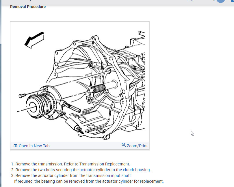

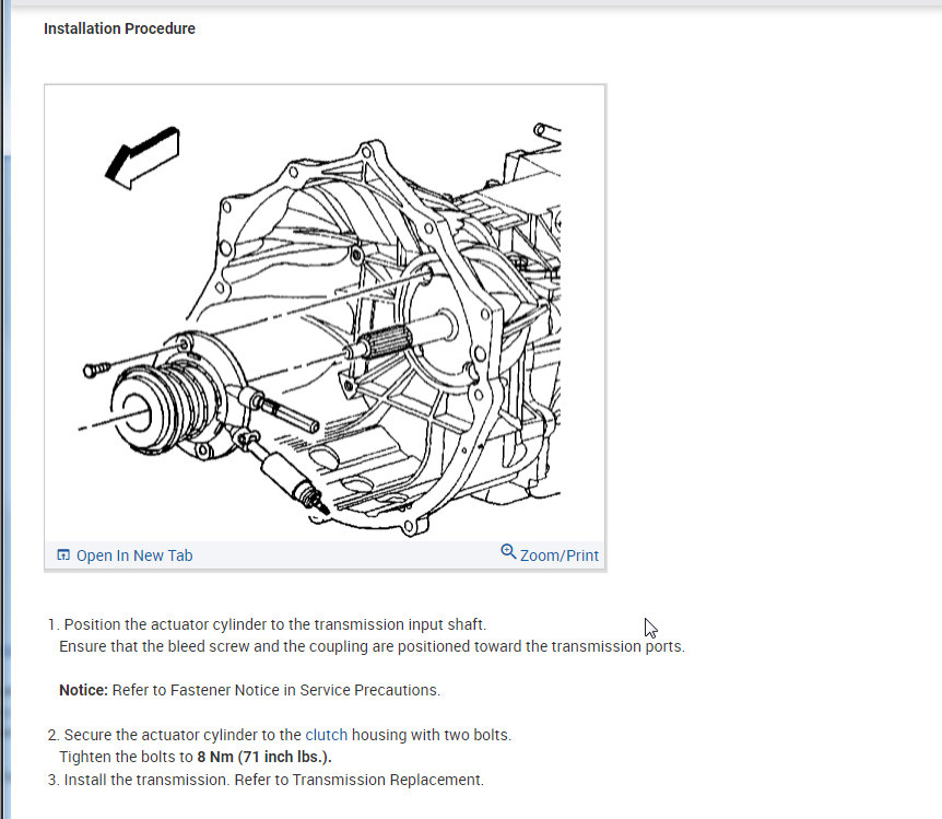

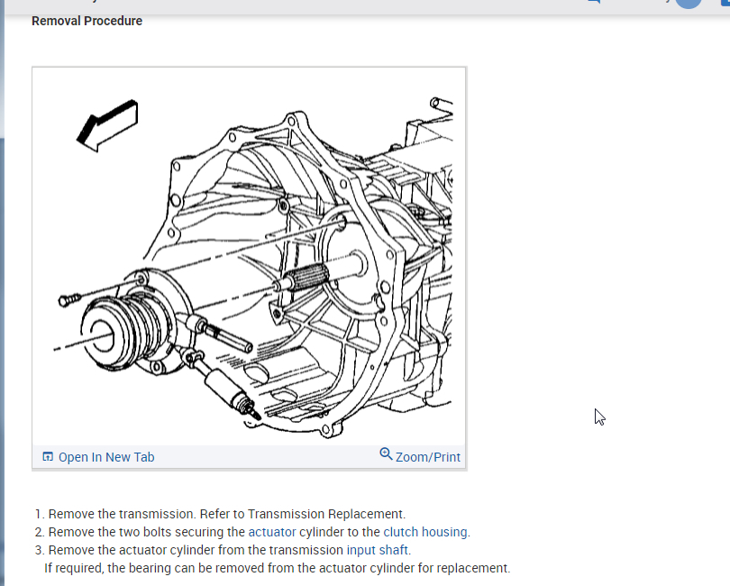

How do you replace the clutch slave cylinder on a 2000 silverado? I.e. do you need to take the tranny out in order to do this?
May 6, 2021 at 5:29 AM (Merged)
Here is a guide that will help with this.
https://www.2carpros.com/articles/throw-out-bearing-replacement
Below is the info from the manual. It will give the detail that you need. However, yes, you need to remove the transmission to replace this.
Please let us know if you have other questions.
