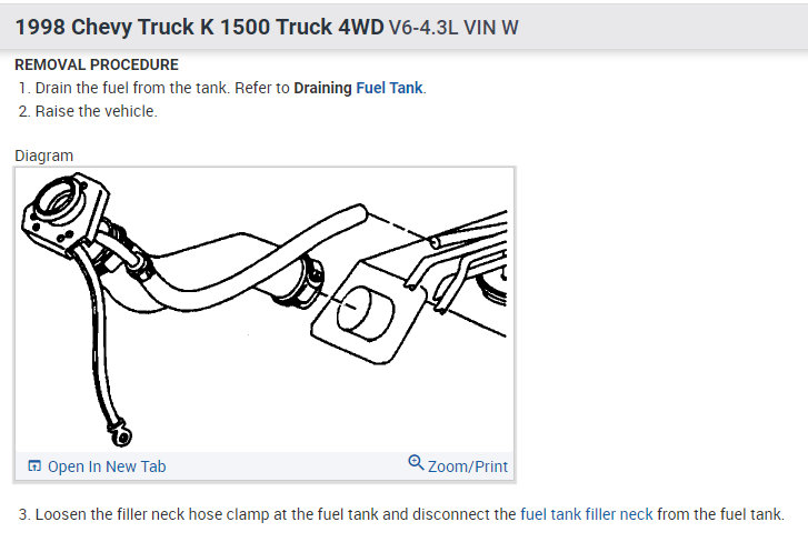

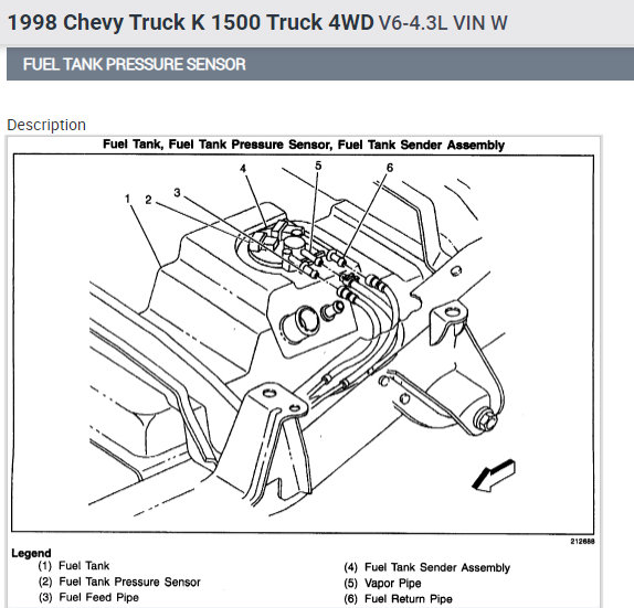

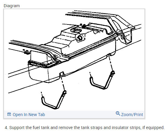

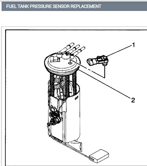

i would like to know where the fuel vapor pressure sensor is located on my truck. i have tried to get a layout of it on the internet but i cannot find one can you please tell me where exactly it is located it would be greatly appreciated. thank you.
Jan 18, 2010 at 12:04 PM
DANNY L
  • CAR REPAIR CONTRIBUTOR
  • 5,648 POSTS
Hello, I'm Danny.

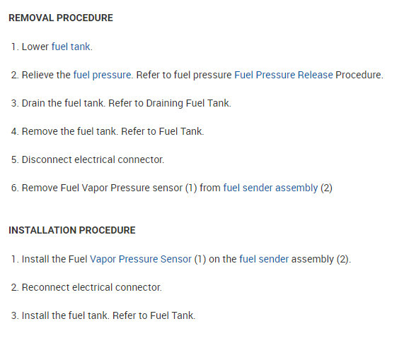

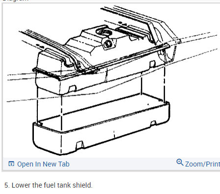

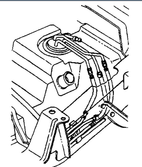

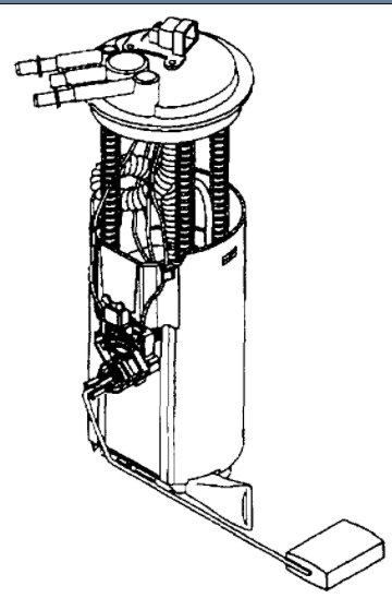

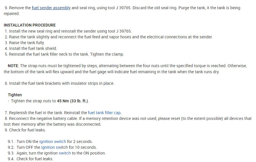

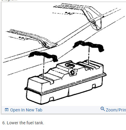

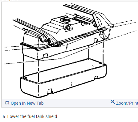

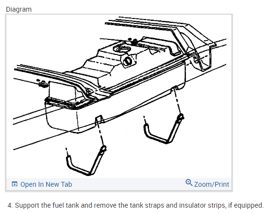

The fuel pressure sensor is located on the in-tank electric fuel pump module. Here is a tutorial showing how to remove and replace an in-tank fuel pump:
https://www.2carpros.com/articles/how-to-replace-an-electric-fuel-pump
You will first need to remove the fuel tank to gain access to the fuel pump. I've attached picture steps below on how to remove and install the fuel tank, fuel pump, and the fuel pressure sensor including its location. Hope this helps and thanks for using 2CarPros.
