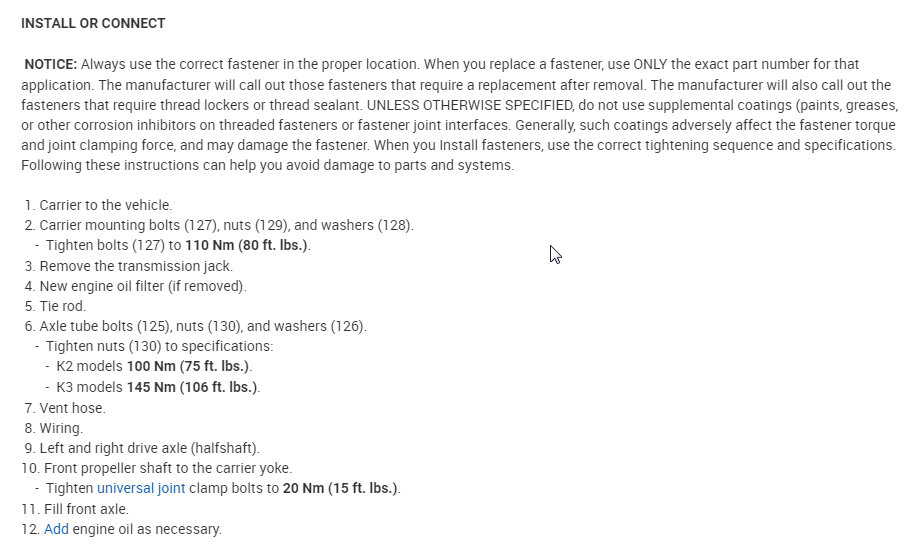

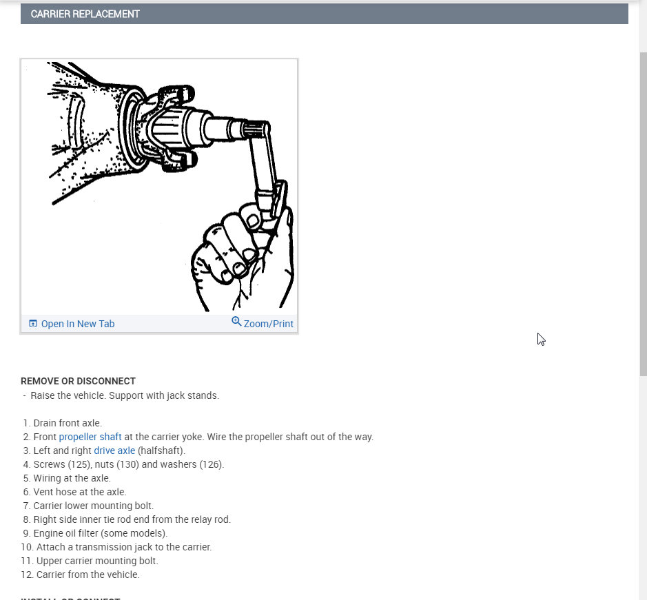

Most likely this is a failed bearing that is no longer supporting the carrier. This results in metallic clicking from what is called gear clash. This is where the gear teeth click together because they are binding under the load you are adding by accelerating and then they release quickly and the teeth click together.
The only way to fix this is pull the carrier out, inspect all the teeth. Then reset your pinion depth and backlash. Once this is set and you have new bearings in place, your noise should be gone.
Here is some detail about this. Let me know if there are questions. Thanks
