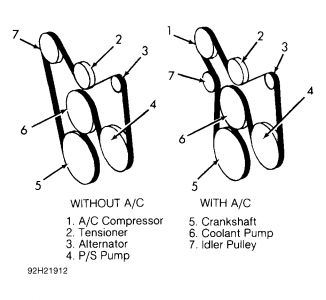

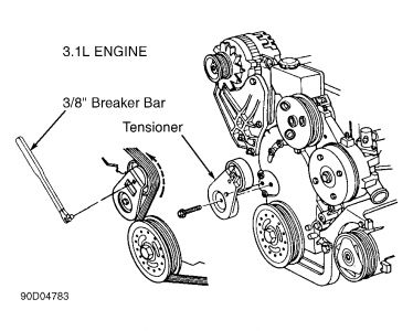

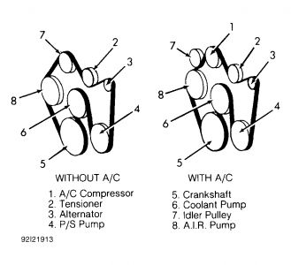

How do I release the tension on the serpentine belt so I can replace the alternator.

That's what I needed. These are the routing diagrams for both with air pump and without. Tighten that single bolt in the middle of the tensioner.

It seems that the bolt on the pulley that the belt rides on will not tighten? I will go try again.
When I first started the project, I did not know how to release tension, so I loosened the bolt on the part that has the spring in it, I realized that was wrong and then tightens it. Then I found out that I needed to put a wrench on the "pulley" bolt and turn counter clockwise
So you are saying to have the belt in the correct position and then tighten the bolt that is in the "pulley touching the belt?
Thanks, sorry for the confusion(on my part)
Saturday, September 6th, 2008 AT 3:23 PM
MERLIN2021
  • 17,250 POSTS
Make sure the tensioner is installed right, there is a peg on the tensioner and a hole in the block, this keeps the tensioner from moving, then use the wrenches or square drive wrench to move the tensioner and put the belt on.
