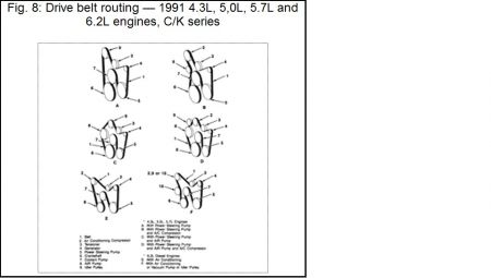

serpentine belt diagram for a chevy silverado 1991

Hi, not sure if diagram is readable? Note the engine litre sizes.
https://images.2carpros.com/forum/automotive_pictures/170934_belt_routing_2.jpg
