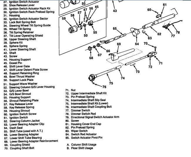

I used to get in my truck and would grab the steering wheel know the tilt part of the steering wheel is way loose what is the problem, and how can I fix it. My manual does not show a diagram, please help.
Jan 26, 2009 at 9:02 AM
BILLYMAC
  • 2,204 POSTS
The entire upper part of the column has to come apart. There are a couple specialty tools needed along the way.
None of the manuals give a step-by-step on taking it apart
Attached below is a blown up diagram of the column assembly, hope this helps

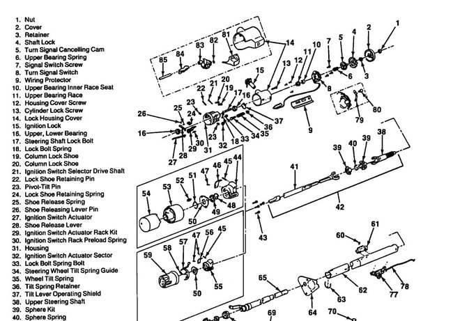

I recently fixed the exact problem that you are having, with the steering column.The problem is me getting it back together. I seemed to have not jotted down where a small spring goes.
It seems that the steering column has different layers.First, take the steering wheel off, then the plate. You will need special tools for these.You can rent them from most auto part stores. you will have to get down past the plastic "plate", then go under the dash to unscrew the metal bracket. This bracket holds wiring harnesses and the column in place.When you take the plastic off, gently pull the wiring harness up enough to give room to get into the center of the column.There will be small screws that you will have to tighten. this is where my problem was. you can have just enough room to stick a screw driver into the area, to tighten. Any other questions feel free to email me.

Sounds like the pivot pins for the tit wheel broke. They make a special tool for removing them, but you can just use a small bolt threaded into the holes, then pull the pins out with a pliers.
The hardest part may be getting to the pins as there may be trim covers to remove. Your best bet is to get a copy of the manufacturer's service manual. Don't waste your money on a Haynes manual. Those don't cover things like this.
You should be able to hold the steering wheel up in the correct position to drive for a short distance.
