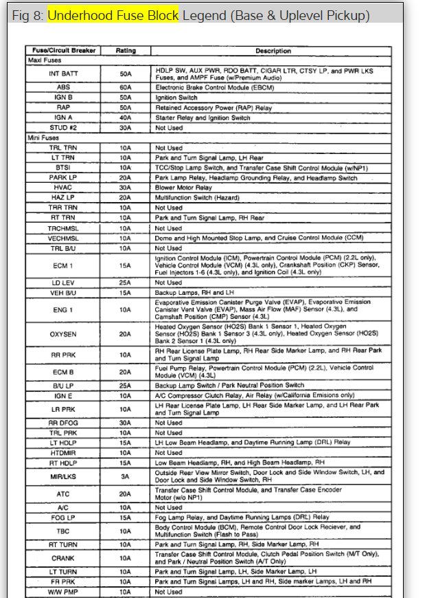

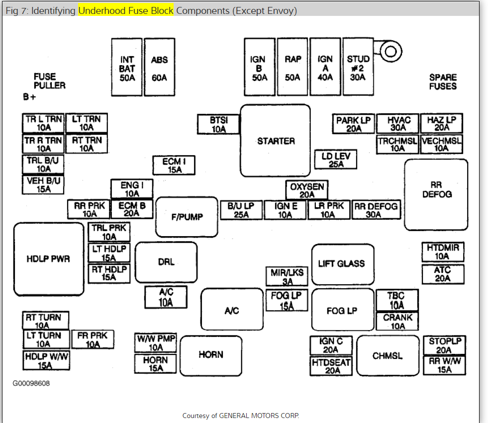

It does sounds like the relay is bad but to be sure here is a guide to help you step by step with instructions in the diagrams below to show you how on your car.
Check out the diagrams (Below). Let us know what happens and please upload pictures or videos of the problem.

yes i put in a jumper at the relay and the fuel pump will run.. i put in a new relay and it fixed it thank you for the guide.

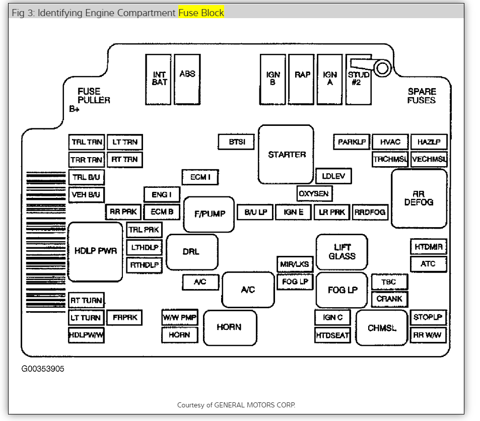

fuel pump not working. have replaced it with a new one, no luck. No voltage at grey wire to pump.
Have swapped out the relay, no luck
Have check the fuse next to the relay, okay. There is voltage at the fuse (test light)
I have read there is a place where you can test the circuit by providing a 12 volts jumper which should then cause the pump to run (or tell you there is a problem like a broken line - grey wire). But I don't know where this is.
Assuming the line is okay to the pump, what am I missing that is keeping the pump from getting power?
The engine has spark and so on. does not run. No code comes up via the scanner.
Mar 6, 2021 at 3:35 AM (Merged)

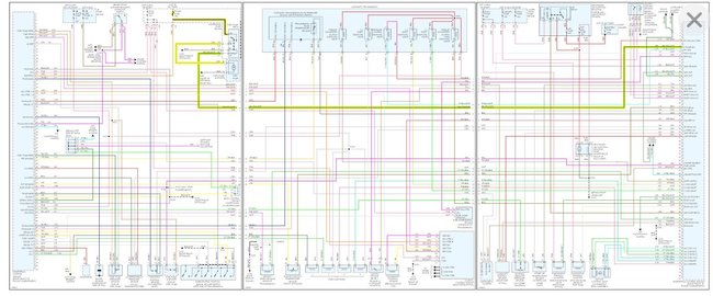

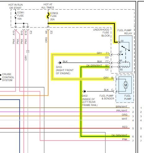

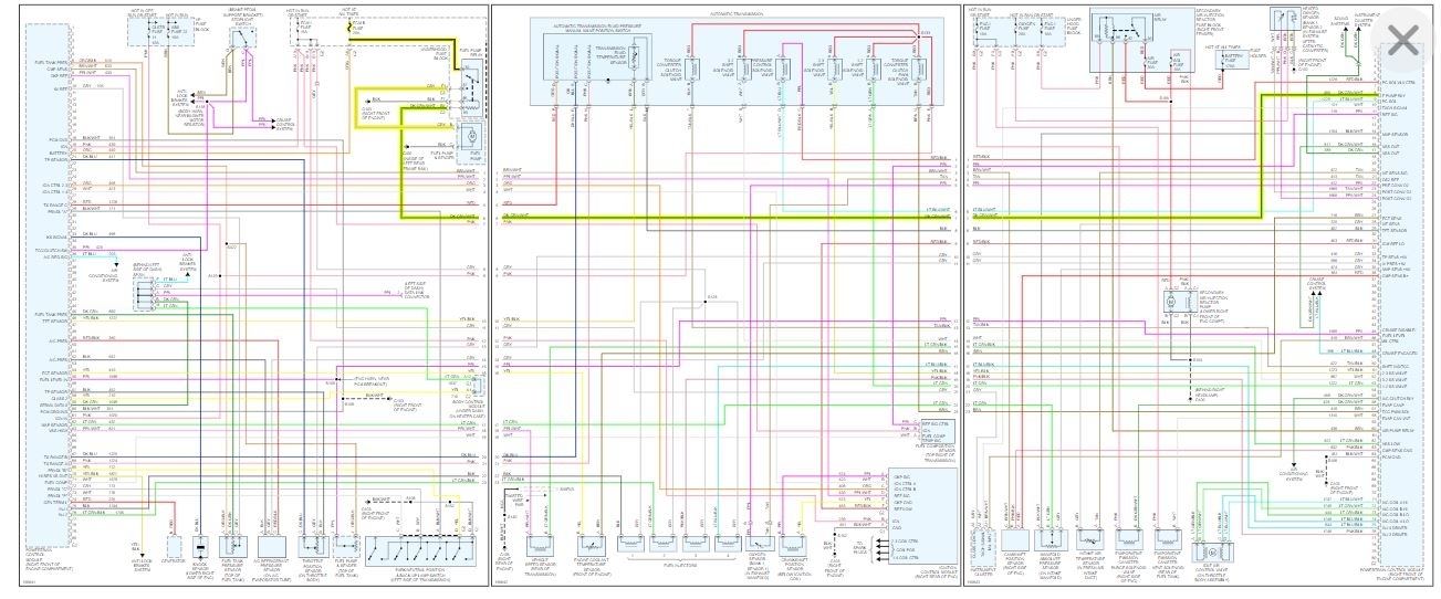

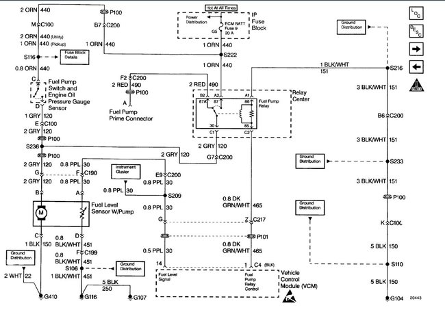

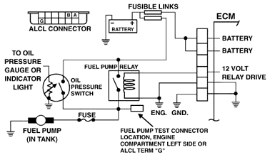

Good morning,
Attached a wire diagram for you to view. Please verify powers to the relay with the key on for me and let me know the voltage.
The primer wire you are talking about was for the older models and is not in your truck.
JOHN & RAY
  • 5 POSTS

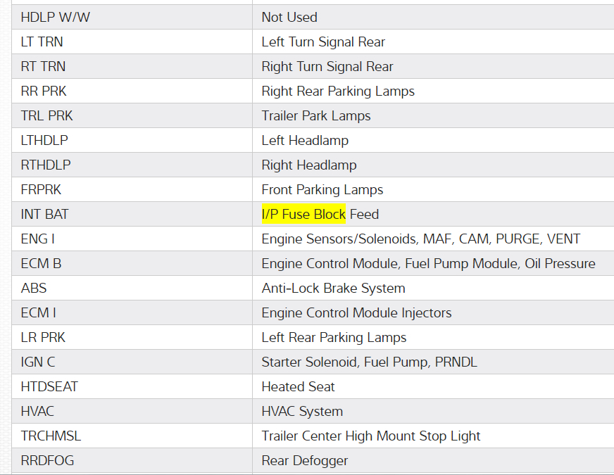

So voltage at the ECM B fuse with the fuse removed and the relay in place?
or fuse in place and relay removed?
(Or both, since I'll be right there?)
Thanks!!
Fuse in place. Test for power to pin 30.
The other, 86, should only have voltage with the key on for 2 seconds as it comes from the pcm. It will keep voltage while cranking.
If you jump 30 and 87, the pump should run.

Look at the bottom of the relay. They should be marked 30,87,86,85.
You jump the 12-volt power or pin 30 to 87 which is the gray wire to the pump.
Mar 6, 2021 at 3:36 AM (Merged)

JOHN & RAY
  • 5 POSTS
Okay! We got it running. The grounds for the computer and other electrical's were rusted and not working. 218,000 miles in New England does that, sadly.
thanks for the great information. we have printed it all up and tucked it away for future reference.
John

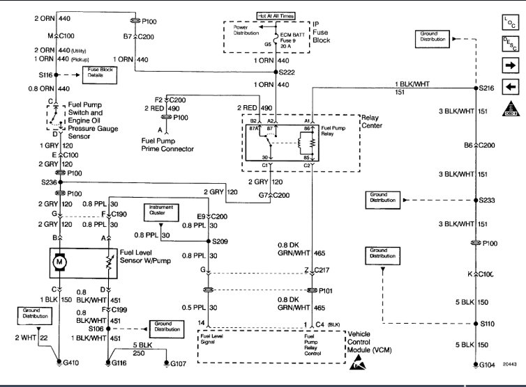

WM V
fuel pump just stopped took it out of the tank check the connections an no power, checked the relay & fuses all good, have power at the relay,tryed another relay an still no power at the pump, what am i missing??
Mar 6, 2021 at 3:38 AM (Merged)
  • 75,992 POSTS
The computer energizes the fuel pump relay and relay will de-energized in 2secs. At which time when the vehicle fires up the oil pressure sending unit powers the pump-All you got is 2secs to check for power at the connector. Also see below
https://images.2carpros.com/forum/automotive_pictures/12900_oil_sending_unit_and_fuel_pump_circuit_48.gif

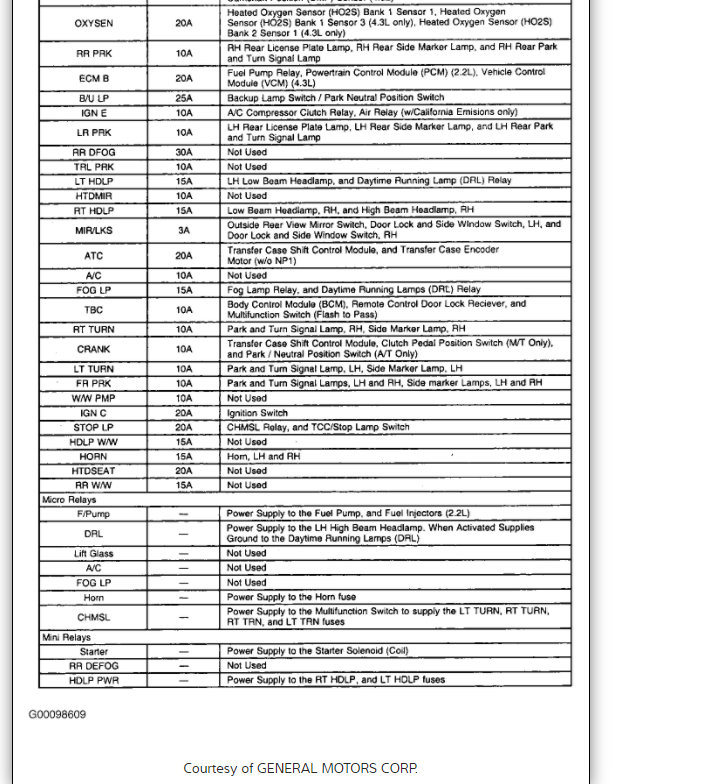

Hi, the relay is located in underhood fuse box. Here is guide to help check it with the relay location below.
Check out the diagrams (Below). Please run this test and get back to us.

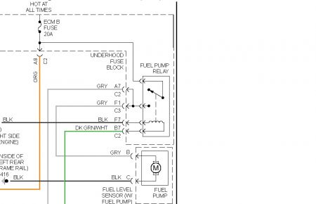

99S10EXTREME
Please i need an answer..I unplugged the fuel pump turned the key to reset the pump plugged it back in.I checked the fuses they are good even checked the relay to the pump.Still not coming on or making any sound it worked good the day before. I even checked the grounds at the back of the truck.Everything has power except the fuel pump.
Mar 6, 2021 at 3:40 AM (Merged)
INTERNETMECHANIC
  • 700 POSTS
Did you use a voltage tester on the circuits in question? At the fuel pump connector, gray is voltage, check with engine cranking. Black wire is ground. If no voltage, start by checking voltage circuits at the relay. Also, disconnect voltage to injectors, when testing the pump. The fuel pump relay, also supplies voltage to the injectors.

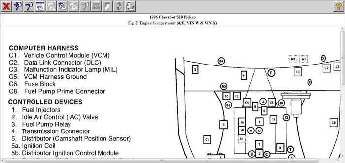

CECIL ANDREWS
1996 S10 Blazer (4.3 4WD). Turned over but wouldn't start. It started with starting fluid so I replaced the fuel pump. New pump didn't help. Checked plug to the pump and had about 6VDC for about 2 sec. Plug did not appear to have a ground connection. Tapped solid black wire with a ground connection but didn't help. Tried to test wires but am getting conflicting info on location of Fuel Pump relay. Voltage checks do not seem to match my diagrams so I'm not sure if I am on the correct relay plug. Can you give me some guidance?
Mar 6, 2021 at 3:42 AM (Merged)
  • 75,992 POSTS
Behind glove box, on relay center. See below location no.3

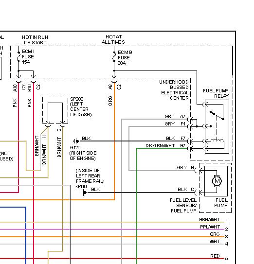

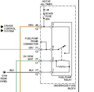

HENRY HOOKER
Okay, I have the truck listed above being converted to a 5.3 LS. I need to know the location and color of the factory fuel pump power wire to connect a 5.3 harness fuel pump wire to. There's pull relays mounted to the back of the firewall I don't know which one is which or what wire do what. please help me.
DANNY L
  • 5,648 POSTS
Hello, I'm Danny.
Here is a fuel pump wiring diagram for your truck. Hope this helps and let me know if you need any further wiring diagrams to make your LS swap work. Picture is attached below.Hope this helps and thanks for using 2CarPros.

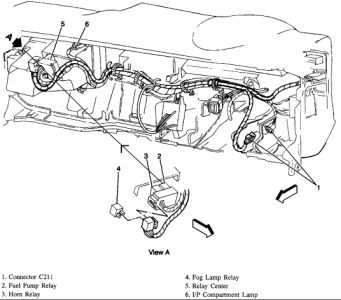

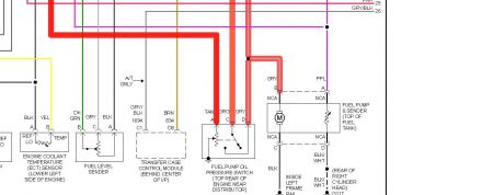

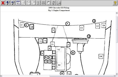

TAMEY_K
plz tell me where to find the fuel pump relay on my 1995 s10 2wd 4 cyl .also i would love to have a
osu diagram i replaced the fuel pump (had some one do it)about 3 to 4 years ago ...now im having problems while driving ,even after it sits all night it will occassionally just shut down ,sometimes re starts or not start at all ...later it will.
  • 75,992 POSTS
Okay the fuel pump relay is at no.3 and the OSU is on no.8 above the A the square box and your fuel pump/oil sending unit electrical circuit is below that.
