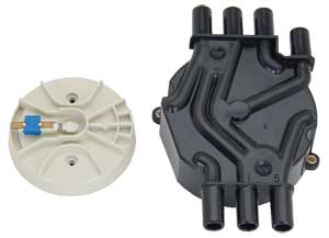

PATSUZ
Got a flat distributor its all black with 7 plug and one coil
https://www.2carpros.com/forum/automotive_pictures/285142_dis_2.jpg
