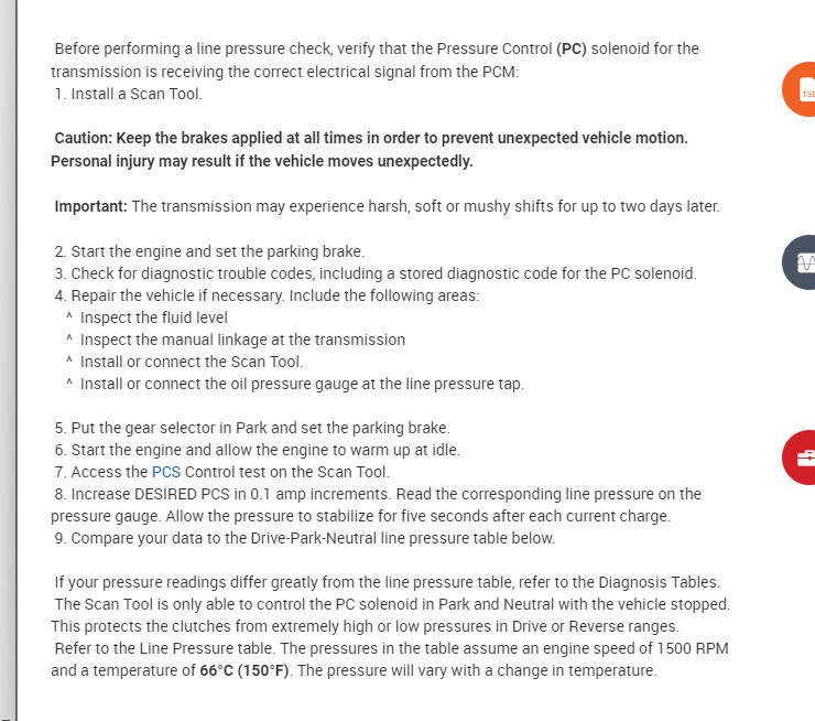

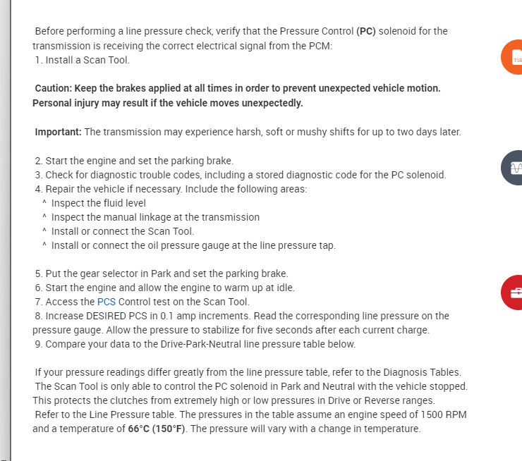

This could be a number of things but the thing to start with is to find out if the fluid is full and in good condition.
https://www.2carpros.com/articles/how-to-check-and-add-transmission-fluid
If the fluid is low, it can cause all sorts of issues like this so we must start there.

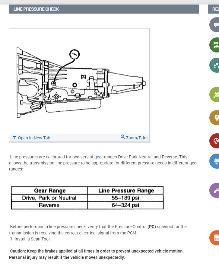

Next we need to find out what the line pressure is when we are going into to reverse.
I suspect the pressure is low which means we have either low fluid or we have an internal issue causing low pressure like a pump or leak.
So, let's check the pressure using the info below and let us know what you find.
Thanks
