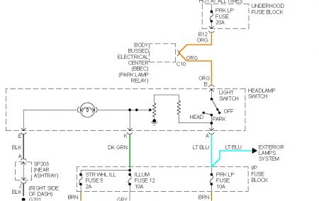

1999 Chevy S-10 DASH LIGHTS WRONT WORK
1999 CHEVROLET S-10
91PROCTOR
Electrical problem
1999 Chevy S-10 4 cyl Two Wheel Drive Automatic
I CHECK THE BULBS IN THE DASH
I CHECK THE FUSES
WHAT ELSE COULD IT BE

Any fuses that you checked, did you check for voltage on the fuse circuit, use a voltage tester. Even if the fuse is good, if no voltage the circuit is dead. If you have dimmer control for interior lites, sometimes the dimmer gets turned all the way down and you have no dash lites. The dash lites are wired throught the headlamp switch. The park lamps fuse, hot all the time, supplies voltage to the headlamp switch for that circuit. The illumination fuse supplies voltage to several circuits including the dash lites. Goes hot when you turn on the headlamp switch.
https://images.2carpros.com/forum/automotive_pictures/512072_chevy_s10_dash_lites_1.jpg
