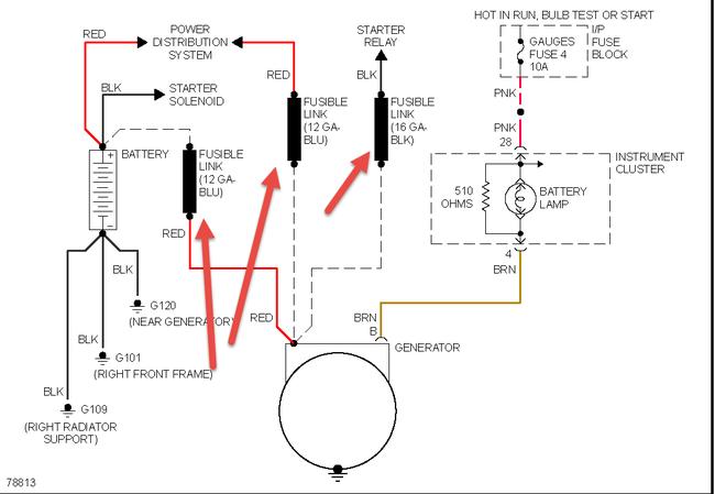

I was helping my dad replace his alternator on his 99 Chevy s-10 yesterday and we had some confusion on the wiring connections on the back of the alternator. There are three wires down there. I know the one with the rubber boot is secured by the lock nut, but where do the other two go. We got everything connected once, and when we tried to start the truck it would not, so we pulled everything back off and saw that we had a wire connected wrong. Once that was connected correctly, the truck would start. However, it will not charge the battery at all. Is there something we have wired backwards or could it be the battery. We are stumped at this, and we are trying to get it fixed ourselves versus a repair shop.

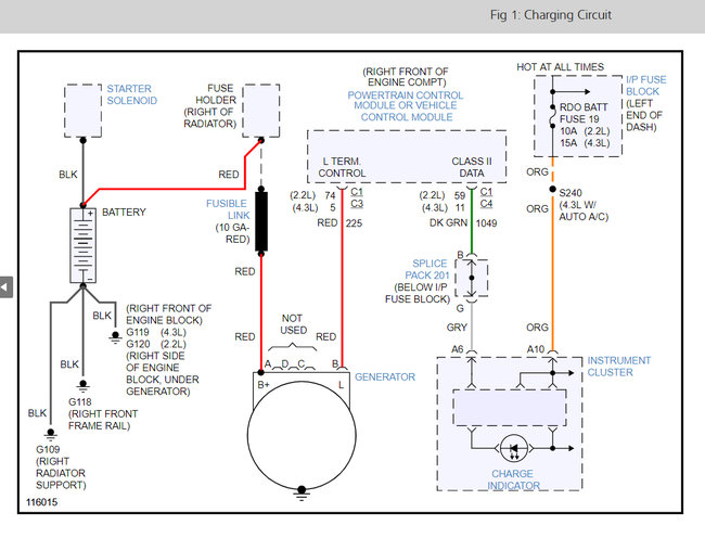

Hi, my info showed this for S10 four cylinder alternator wiring diagrams with a guide to help you test it
Check out the diagrams (Below). Please let us know what you find. We are interested to see what it is.
Jan 24, 2010 at 7:49 AM
RYUGAIDEN05
Thanks, so it looks like from that diagram we have everything hooked up correctly. I took the battery and had it charged today, now the gauge is showing 12 volts on the dash. However, it does not move up any further while I had the truck running.

My S 10 has a new battery and a alternator that checks out at Autozone as charging. All connection are good and clean plus tight. From what I have seen everyone is saying to check the little brown wire that plugs into the alternator for a breakage or bad connection. That is if the vehicle has a light for the battery on the instrument panel (gauge cluster). Well mine has no light at all in has a volt meter gauge. Do you still check this in the same manner as the light? And does the charging system go through the the PCM to command the alternator to put out?
Apr 26, 2019 at 10:57 AM (Merged)
HMAC300
  • 48,601 POSTS
check the three things in pic that I have pointed out and yes still check the brown wire for a bad connection. but the fusible links should have same voltage both sides and not just one or two strands connecting them

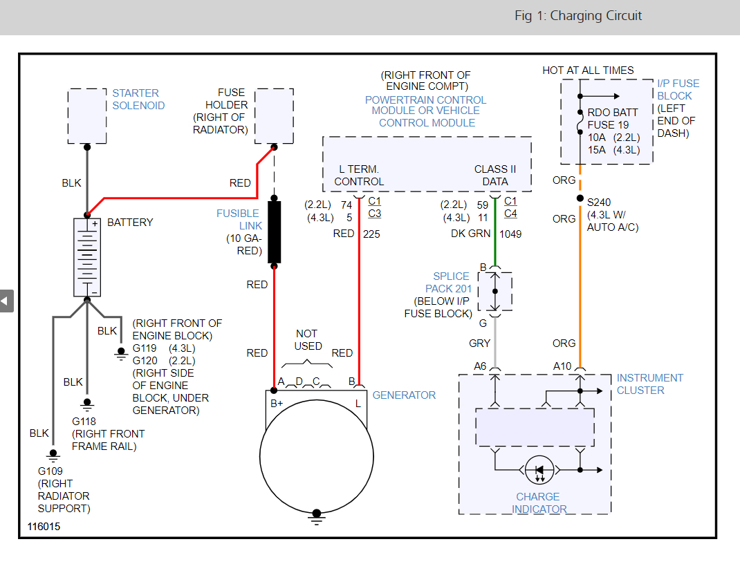

My battery light came on this morning, so I had Auto Zone test and recharge my battery. Everything is fine there. They said it is probably a problem with my alternator, and I should do some more testing before I have it bench tested. My question is this: what tests should I do on it? Also, my fuel gauge is now stuck 180 degrees from empty, and it's stuck there...what should I do about that?
CARADIODOC
  • 34,381 POSTS
Use an inexpensive digital voltmeter to measure the battery voltage while the engine is running. It must be between 13.75 and 14.75 volts. If it's low, suspect the generator. It is real common to go through four to six of them on GM products, after the '86 models, in the live of the vehicle. To reduce the number of repeat failures, replace the battery at the same time as you replace the generator. As they age, they lose their ability to dampen and absorb the huge voltage spikes the generators produce due to their design. Those spikes can destroy the internal diodes and voltage regulator leading to the repeat failures, and they can cause running problems due to interference with computer sensor signals.
Here is a guide to help
The fuel gauge should find its way to the proper position when you fill the tank. It looks for the shortest way to the desired setting and that might currently be clockwise against the stop.
CSEMRADGO
After testing the battery with a voltmeter, I can tell the battery is not charging because it has roughly 11.6 volts when the engine is running. Next test?

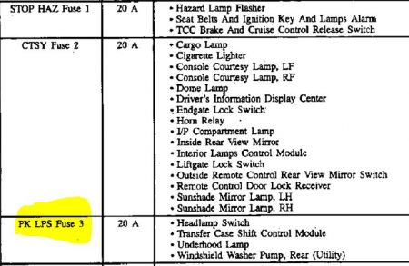

just wanted to say thanks, i narrowed it down to the Number 3 fuse, now to figure out what all is on that circuit and fix it.

So i found a wiring diagram for that fuse, the first thing in line was the under hood lamp, with the test light on, a slight wiggle of the lamp caused the test light to flicker, so i unplugged the bulb and the test light dimmed. so i'll leave it unplugged till i can get the mercury switch replaced. im having a hard time finding information on how much draw the truck should have on the battery while the key is off, right now it measures 3.30v that still sounds high to me but i really have no clue.
