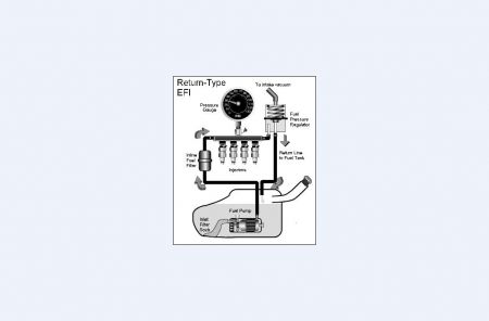

I do not have any fuel pressure. I took the fuel pump out and it runs fine hooked up to the battery. I've swapped the relay 3 times, I've inspected the wiring and it all looks good, I've changed the power connector at the pump. I pressed the relief valve on the gas line and there is no pressure, at most a single drop of gas creeps out. My next guess is the PCM. Any help?

Do you have power at the fuel pump connector gray wire for 2secs when key is at On position. If not could be a problem with the computer fuel control relay Check pin out#8. Also check gray wire at each injector-do you have power?
https://images.2carpros.com/forum/automotive_pictures/12900_fuel_pressure_system_circuit_1.jpg
