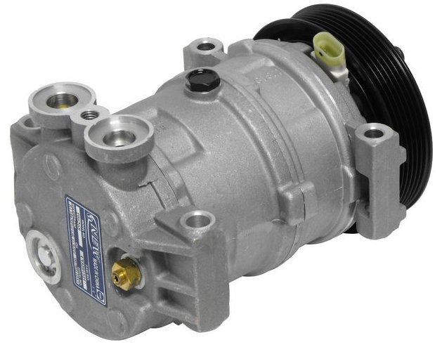

The wire and wire holder going to the back of the compressor has broken off. Can this be fixed without replacing the compressor. The compressor is new! Please help!
Sunday, September 5th, 2010 AT 3:21 PM
SQM
  • 6,383 POSTS
It will depend on where exactly it broke off.
Please upload a picture so we can see exactly what you are dealing with.
If the base is still intact, you might be able to find a solution. But it will all depend on the exact condition it is in.

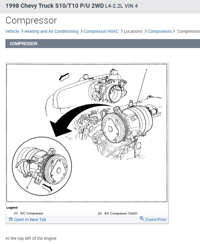

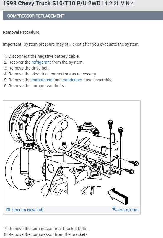

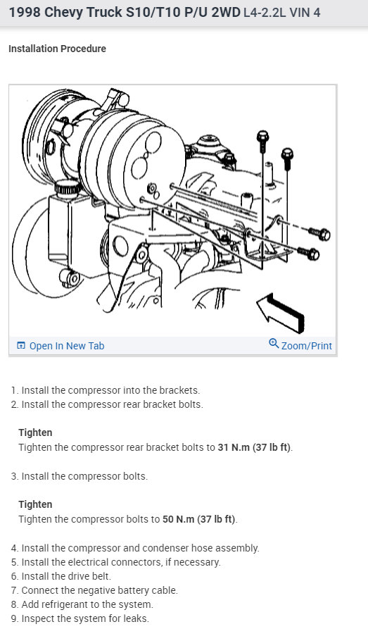

https://www.2carpros.com/articles/replace-air-conditioner-compressor
