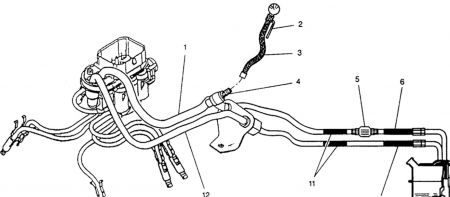

How long since a tune-up? When the problem occurs, use a gage and check fuel pressure. Some of the national brand autostores used to loan out a fuel pressure gage, if you don't have one. The cts could cause fuel issue? Any applicable trouble codes? I need more information.

Yes, you can check fuel pressure, using a gage. The gage fitting screws onto the schrader valve. If there is any pressure on the system, gas will squirt everywhere when you depress the valve. After the vehicle sits overnight, there usually isn't much pressure, but, you still need to be aware. Use a shop rag around the fitting when connecting. In the diagram, #4 is the schrader valve, that diagram is for the spider fuel system. The picture came from autozone, the only one I could find.
https://www.2carpros.com/forum/automotive_pictures/512072_spider_system_schrader_valve_1.jpg

I wouldn't replace anything without doing some testing. Ater you hook-up the gage, key on, no crank, there should be pressure, write it down. Engine running, check pressure. After you turn the key off, see that the pressure doesn't drop like a rock. As far as the cts, coolant temp sensor, I don't see anything definitive? If no fuel pressure, we do some more testing.
