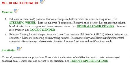

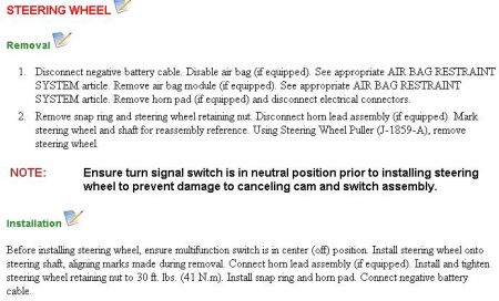

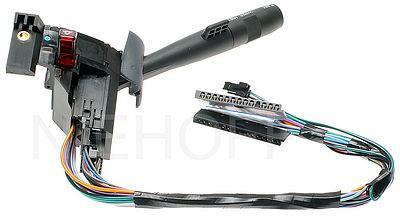

i was removing the trim panel to change out a faulty headlight switch,and i didnt think to lower steering wheel and broke off hazard light switch on top of steering column. now they flash constantly. i removed the hazard fuse and they stopped but so did my brake lights. how do i go about replacing
that little red switch. tyvm

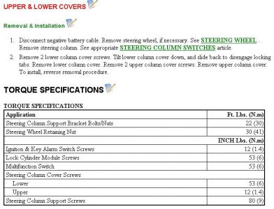

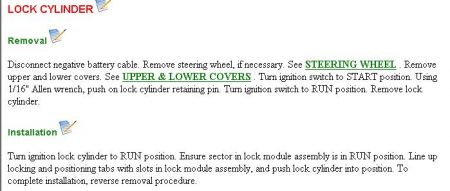

The hazard button is a part of the multi function switch. I don't believe that it can be fixed/replaced individually. You may be able to slide a small flat head screw driver to pop the button to the "OFF" position, but to properly repair it, you need to replace the entire switch.
https://images.2carpros.com/forum/automotive_pictures/55316_cs28111_1.jpg
https://images.2carpros.com/forum/automotive_pictures/55316_96s10mfs1_1.jpg
https://images.2carpros.com/forum/automotive_pictures/55316_96s10mfs2_1.jpg
https://images.2carpros.com/forum/automotive_pictures/55316_96s10mfs3_1.jpg
https://images.2carpros.com/forum/automotive_pictures/55316_96s10mfs4_1.jpg
