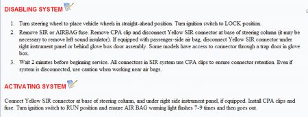

I unhooked the battery to replace the intake gasket it was unhooked about 24 hrs. When I connected it back an got the truck running again the. Air bag light flashes like it's ok but it stays on instead of going out. It's like it charges up an when it's suppose to go out it stays on.

You might need to re do the air bag dissable and rearm steps the right way, post the flash codes too...
https://www.2carpros.com/forum/automotive_pictures/62217_Air_Bags_1.jpg
