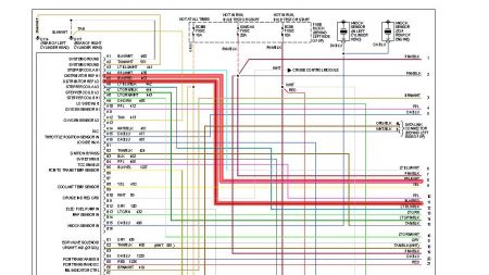

I have a 94 chevy s-10 V6 4.3 TBI, the engine turns over but does not start. I have done some test. The whole fuel injection system is not being powered. I know I have a good fuel pump. I ran a power wire directly to it, to test it. But the injecters still do not turn on. I know it gets spark, I had it running when I sprayed fuel down the throttle body. I had this problem 6 months ago, but it stopped and just started again. Any Ideas?
Monday, June 9th, 2008 AT 1:13 PM
17 Replies
  • 75,992 POSTS
I know i have a good fuel pump.
The only sure way to tell is to actually perform a fuel pressure test with gauge.
Ignition switch at run position you should have power at the red and white wires to the injectors. If not Check ECMl fuse 10amp. If you have power on these wires and the injectors are not pulsing-it coming from the computer ground driver of the injectors. See below
https://www.2carpros.com/forum/automotive_pictures/12900_driver_3.jpg
Monday, June 9th, 2008 AT 2:20 PM

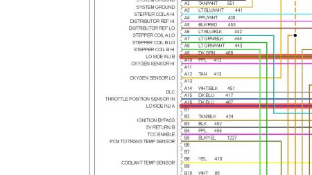

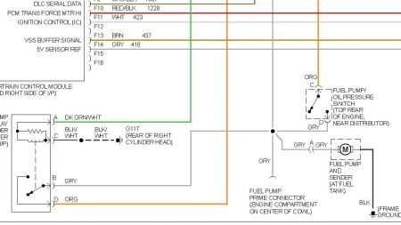

There's no camshaft sensor for this model-some manufacturers uses the camshaft sensor to synchronize the injectors-
Inspect and test the distributor pick-up coil resistances in the distributor and check the wiring all the way to the computer for short and open.
I believe the computer is using the signal from the distributor pick up as the ignition reference to energize the injectors.
https://www.2carpros.com/forum/automotive_pictures/12900_d1_2.jpg
https://www.2carpros.com/forum/automotive_pictures/12900_d2_2.jpg
Tuesday, June 10th, 2008 AT 11:29 PM

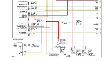

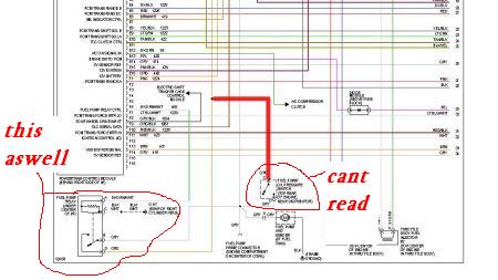

I cant read the resolution so small...
https://www.2carpros.com/forum/automotive_pictures/199646_s10_1.jpg
If you want since this site only let you put low pixle pics you can e-mail me them if you like. 1985sr5@gmail.com

https://www.2carpros.com/forum/automotive_pictures/12900_inj_1.jpg
