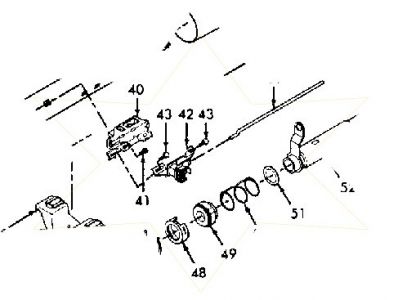

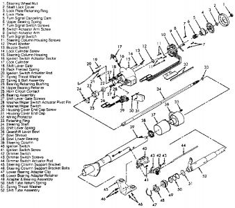

can you tell me how to change this i assume its the unit on the steering column about 8" from the floor i see no screws holding it and can't figure how it would come off it looks like it has 3 wires plugged in it. this will be the 4 one replaced in the last 5 yrs.and the last one in 4 months. i don't have a problem anyone making a dollar but its been running $160 - $185.00 for this and the switch is only $26.00 any help i would be grateful
Mar 11, 2008 at 9:35 AM
SERVICE WRITER
  • 9,123 POSTS
Do you have column shift or floor shift? This is column shift:
https://images.2carpros.com/forum/automotive_pictures/30961_as101_1.jpg
https://images.2carpros.com/forum/automotive_pictures/30961_as102_1.jpg
#42 is the switch.

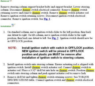

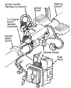

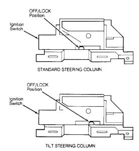

mine is the colum shift it looks like the switch is outside on mine but after looking at the diagram does that mean i'll have to take the colum apart?
Mar 11, 2008 at 11:02 AM
SERVICE WRITER
  • 9,123 POSTS
No it doesn't, I just didn't want to upload this if this wasn't what you had.
https://images.2carpros.com/forum/automotive_pictures/30961_10s1_1.jpg
https://images.2carpros.com/forum/automotive_pictures/30961_10s2_1.jpg
For reference:
https://images.2carpros.com/forum/automotive_pictures/30961_10s3_1.jpg
