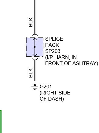

You have to have a ground problem someplace because when things work when you say they do you are putting more power in to make the radio work. Check the ground in both pics the right side of dash also works for radio ground. It may be near the ashtray. Also check the relay under hood for corrosion if it has it clean as best you can then use dielectric grease on prongs.

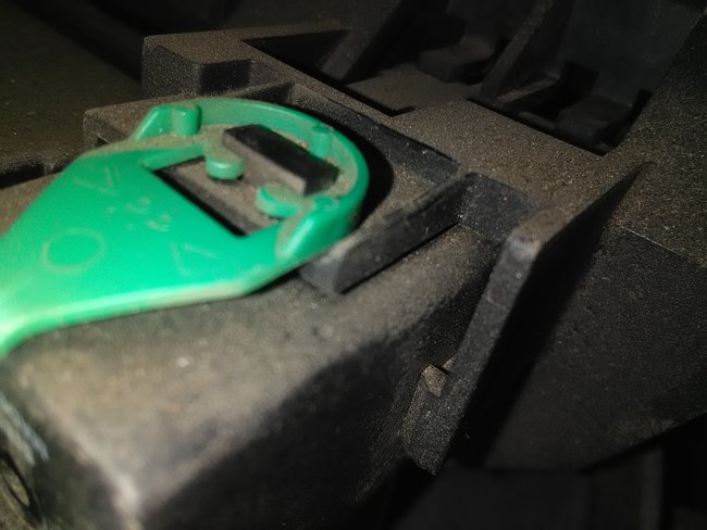

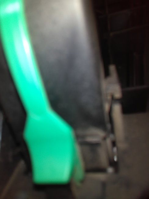

I found this relay in the dash but couldn't get that green strap off and ran out of daylight but the battery wet dead and it started clicking and almost buzzing it was doing it so fast bit I put a stronger battery in it and it quit but I was wondering if that was the relay you were talking about it on the fat right side of the dash board

  • 48,601 POSTS
It says on pic body relay block left side of dash

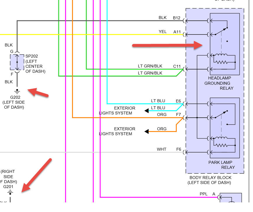

Some of the guys have found the black wire going to ground on headlight relay which is already in a previous answer is burnt not letting headlight ground check there you'll probably have to pull that relay block to find it. You'll see it if it's burnt. Then check power through multi function switch.

Ok that headlight relay is next to the battery kinda inside the body right? I have a hard time reading the diagram.

  • 48,601 POSTS
That relay is on the lh side of dash maybe the one with green strap you are talking about.
