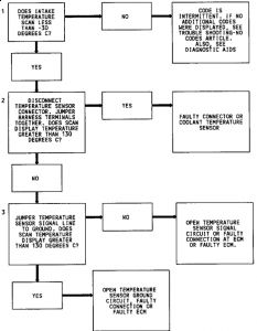

after looking up this code, "intake air temp cool" do I need to replace a sensor? service engine light will come on after engine has warmed up & is idling.

would suspect faulty intake temp. sensor but may want to follow troubleshooting chart below..(if chart is too small, post your email addy so i can send to you larger)
