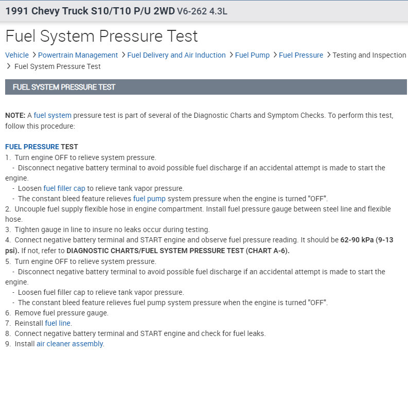

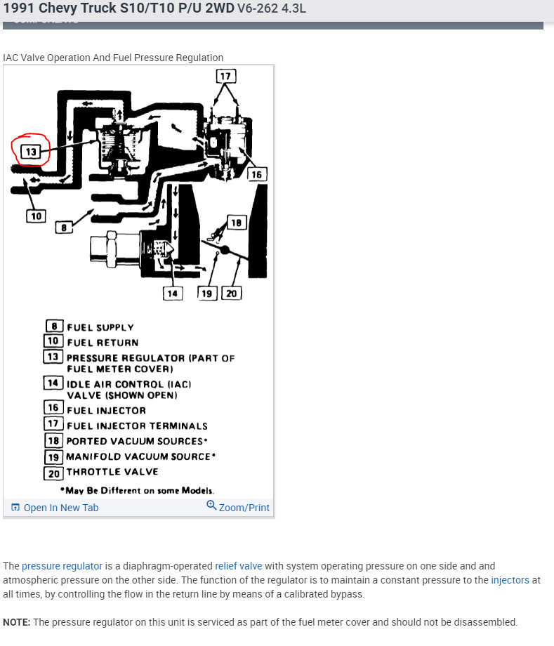

You might want to check the fuel pressure. If there is a restriction in the line or a bad pressure regulator, this can starve the engine from fuel, and it will not stay running.
This vehicle should have 9-13 PSI of fuel pressure.
Here is a helpful guide on how to check the fuel pressure:

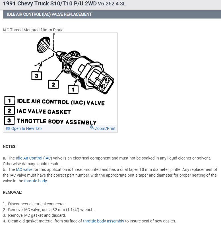

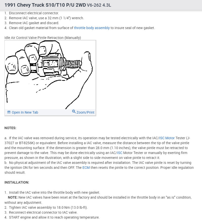

Another possibility is a dirty idle air control valve. This can also impact the way the engine idles and start up.
The IAC can be cleaned to restore its performance.
https://www.2carpros.com/articles/idle-air-control-valve-service
