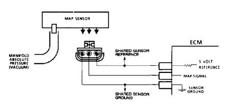

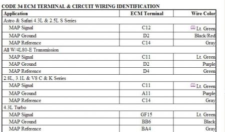

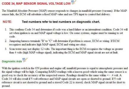

when the code 34 comes up it says' circuit to high/ to low'.What circuit is it refering to. idle, voltage ? . Thanks ,billy (New map was installed)
Jan 31, 2009 at 5:34 AM
BLUELIGHTNIN6
  • 16,542 POSTS
Is referring to voltage to the MAP sensor. Below are troubleshooting procedures for the code..
