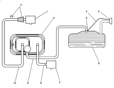

keep receiving a tighten gas cap signal on dash along with a steady check engine light. Bought a new gas cap three times, each time except this last time the check engine light went away. Now it has been on for over a week and keeps saying tighten gas cap even with new cap installed again. Have even tried changing fuel type from regular to mid-grade and still have the same problem

Yes need code number there are about 75 codes dealing with Evap failures. need in P0xxx format
Aug 25, 2009 at 2:50 AM
VALSEVEN
the code is po455
Aug 25, 2009 at 4:01 AM
DOCFIXIT
  • 18,828 POSTS
That is for large Evap leak. testing requires some special equipment. Other than visual inspection of system, see diagram, will likely be hose off evap canister . or line kinked or off tank. This may need a trip to shop but first open hood lok around .
